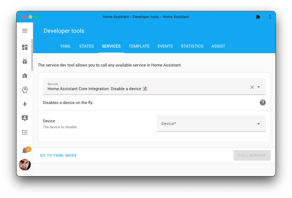

Sure, just disable your cloud integrations. If you want to do that with an automation rather than manually then check out the Device actions the Spook integration provides.
