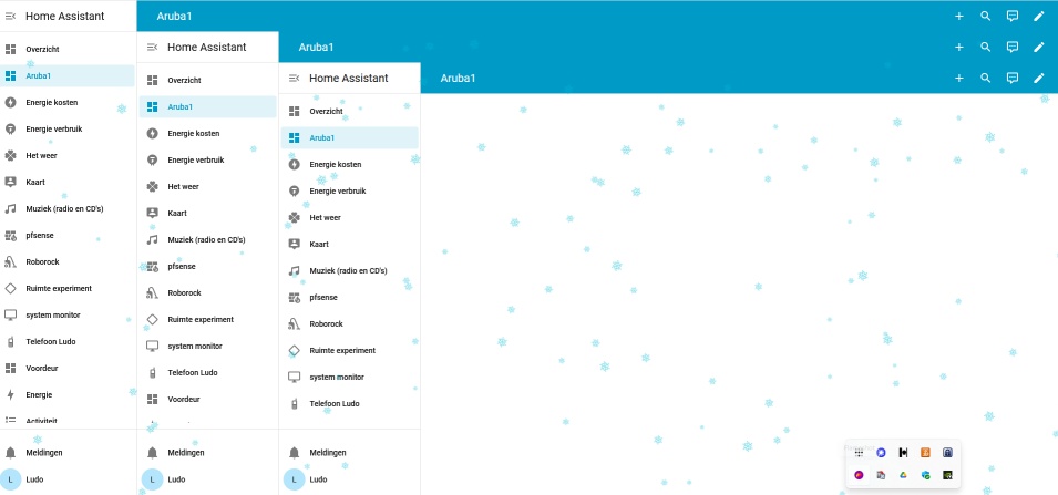

When I enter the Aruba’s IP address locally in a webpage dashboard, I get a cascade effect: two identical images.
In Firefox Add-on, the webpage is fully accessible.
