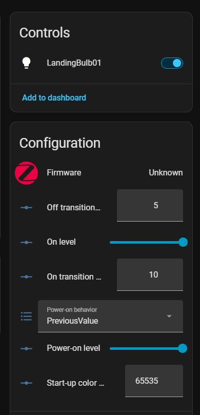

I have just bought 5 Zigbee bulbs (candle shape), model: TS0505B.
I only have very basic settings, yet I understood these to be colour changing.
Spec: Zigbee 3.0 Smart Light Bulb RGBCW 2700-6500K LED
Discovered as:
I cannot see any discernible difference between different power on levels, nor start up colour.
No options to select a colour.
Searched for previous posts on this model on here and can see some people did have the colour wheel available.
I did delete it from ZHA and re-add, no different.
Any suggestions?
Edit: Forgot to to say, I have the SONOFF Zigbee 3.0 USB Dongle Plus V2 dongle. Other Zigbee devices work ok.

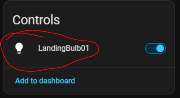

Click here :wink:
So when you click on the light entity's name what options are shown? Just on/off?
Thanks both of you, this worked.
So it was down to my lack of knowledge/wrong expectation of how it would work :slight_smile:
