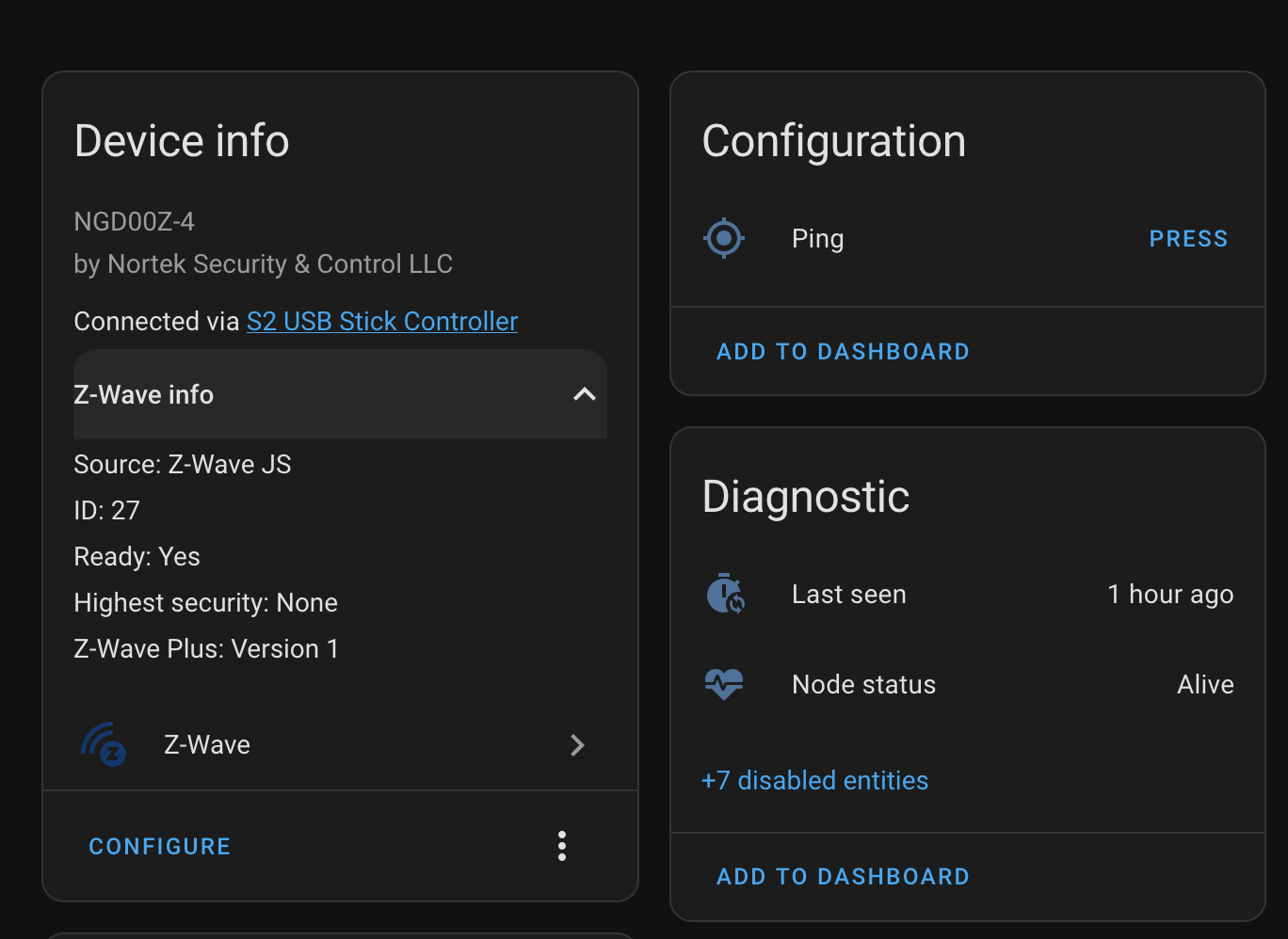

I successfully migrated my Linear GD00Z-4 garage door opener from SmartThings to Home Assistant. The device pairs with my Zooz 700 controller without errors, but I’m not seeing any entities for actually opening or closing the garage door. The device shows as connected and ready, but no control entities are created.

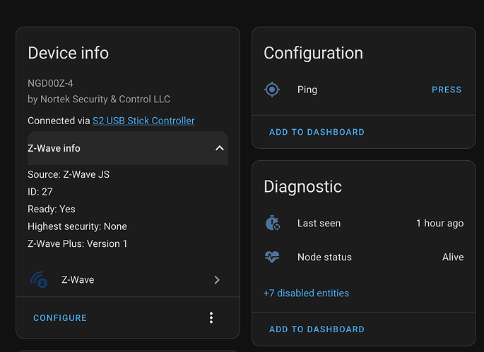

It was not paired correctly, given the “Highest security” is shown as “None”. GDOs require secure inclusion, whether S0 or S2. If it failed secure inclusion you should have been given a warning about it.
You’ll have to exclude it and try again, you cannot change the security level after inclusion. Make sure your network is healthy to avoid errors during security bootstrapping: https://zwave-js.github.io/zwave-js/#/troubleshooting/first-steps

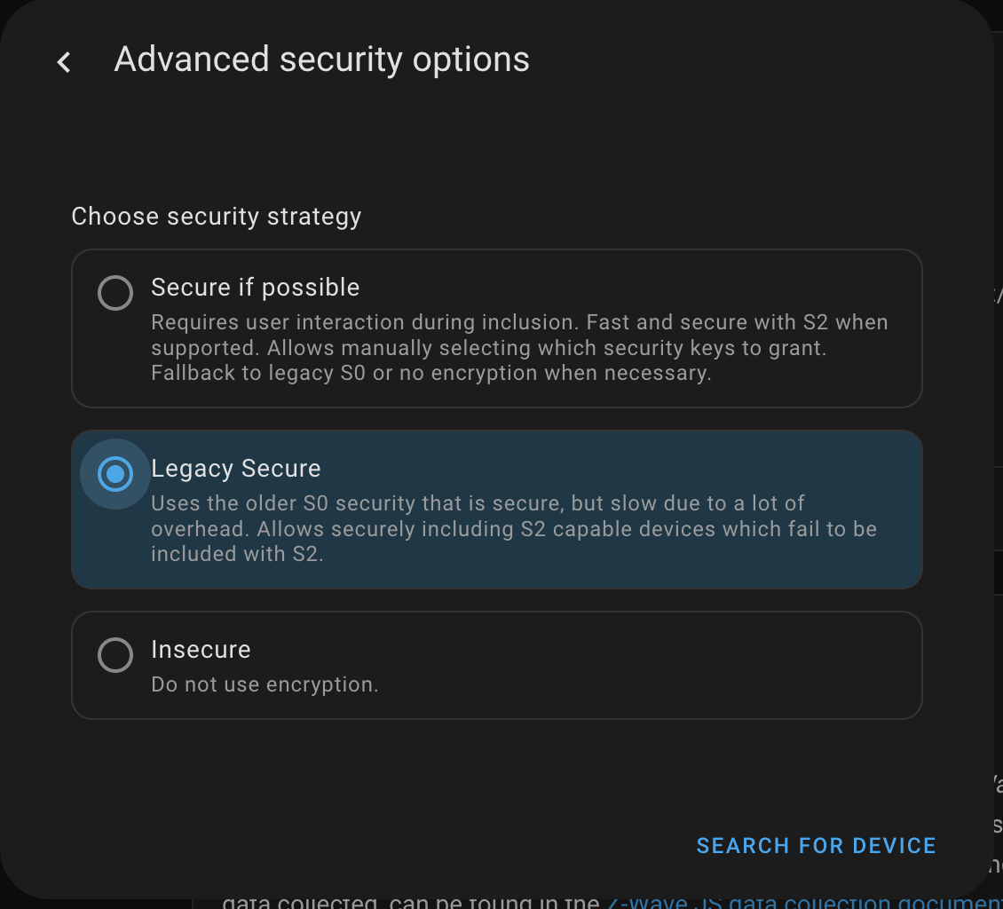

Also I seem to recall there were some Linear GDOs that claimed to support Security 2 but actually do not. In that case ZJS won’t include it properly. You could try forcing Legacy (S0) inclusion instead.

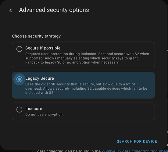

@freshcoast Thank you I am now connected. This is what I did:
  1. I excluded the GD0
  2. Then reset my GD0 long press button for 5 seconds hear the beep
  3. Wait ~1 min
  4. Press the button 5 times
  5. Wait ~1 min
  6. Went to add device. Clicked advanced. Then clicked legacy secure (as seen in screen shot)
  7. Opened the garage with existing system to recognize if it is open or not.
  8. Then closed garage with GD0.
