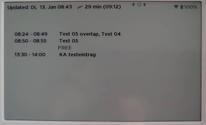

08:24 - 08:49 Test 05 overlap, Test 04\n08:50 - 08:55 Test 05\n13:30 - 14:00 KA testeintrag
which only is ASCII with start-end subject and takes overlapping dates into account.

See here the ePaper:
