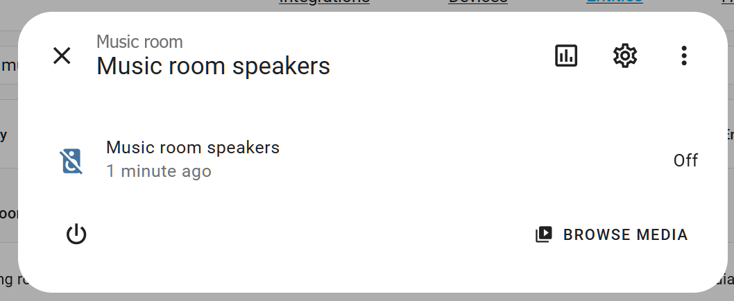

This is the status I see for the media players while Qobuz connect is playing.
LinkPlay :
Google cast :

I found a workaround to this problem : I enabled the WiiM devices in the DLNA renderer integration.
This one does change status when using Qobuz connect, and is thus able to trigger my automation to turn on the corresponding amplifier.
