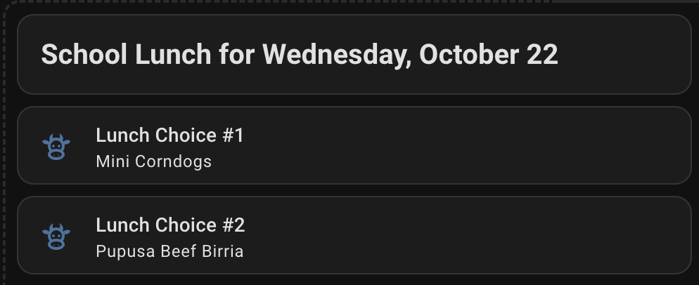

I also created a set of cards on the dashboard to display these:
- type: grid
        cards:
          - type: markdown
            content: >-
              ## <ha-icon icon=""></ha-icon> School Lunch for {{
              as_timestamp(states('sensor.lunch_date')) | timestamp_custom('%A,
              %B %-d') }}
          - type: tile
            entity: sensor.lunch_entree_1
            name: 'Lunch Choice #1'
            icon: mdi:help-circle-outline
            state_content: state
            vertical: false
            features_position: bottom
            card_mod:
              style: |
                ha-tile-icon {
                  --card-mod-icon: {% if is_state('sensor.lunch_entree_1_has_allergen', 'True') %}
                    mdi:cow
                  {% elif is_state('sensor.lunch_entree_1', 'No lunch today')%}
                    mdi:food-off-outline
                  {% else %}
                    mdi:cow-off
                  {% endif %};
            grid_options:
              columns: 12
              rows: 1
          - type: tile
            entity: sensor.lunch_entree_2
            name: 'Lunch Choice #2'
            vertical: false
            card_mod:
              style: |
                ha-tile-icon {
                  --card-mod-icon: {% if is_state('sensor.lunch_entree_2_has_allergen', 'True') %}
                    mdi:cow
                  {% elif is_state('sensor.lunch_entree_2', 'No second lunch')%}
                  {% else %}
                    mdi:cow-off
                  {% endif %};
            grid_options:
              columns: 12
              rows: 1

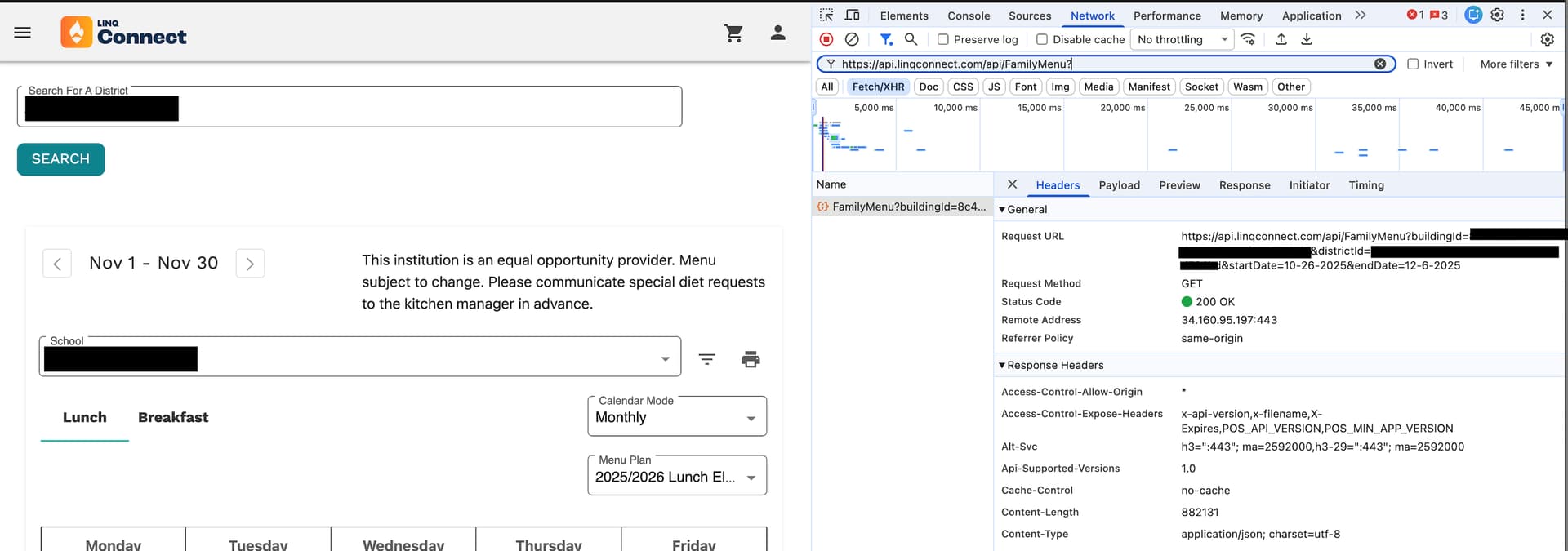

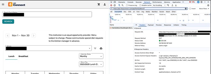

Can you describe how you identified the {building id} and {allergen id}? I can find the {district id} through the schools website but unsure how to identify the others. Any help would be much appreciated. Thanks!
If you go to your school’s page on LinqConnect LINQ Connect - Making Schools Stronger, open the network tab and search for https://api.linqconnect.com/api/FamilyMenu?, and copy the buildingId
For allergenId list, you can search the network tab for 'allergy and look at the response tab for a mapping of allergen to Id.

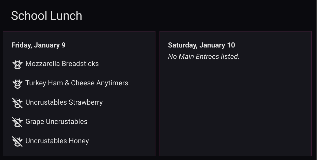

I finally made the switch to pyscript for this and it has been so much better. Now I can get all the lunch menu items instead of just the first two. My kids are much happier seeing everything on our home dashboard :slight_smile: .
If you’re interested, here’s what I did:
  1. Create 3 text helpers, and add the appropriate values:
  • input_text.school_building_id
  • input_text.school_district_id
  • input_text.school_allergen_dairy (change this to be your specific allergen if desired)
  1. Install pyscript via HACS
  2. Add the following script in /homeassistant/pyscript/school_menu.py. This will create a script to update the menu info every 3 hours, and put it into the sensor sensor.school_weekly_menu:
# /config/pyscript/school_menu.py
import requests
from datetime import datetime, timedelta
# --- 1. Scheduling and Main Function ---
@time_trigger("startup")
@time_trigger("cron(0 0,3,6,9,12,15,18,21 * * *)")
async def update_school_menu():
    """Fetches menu data, processes it, and sets the Home Assistant sensor state."""
    # 1. Get Configuration IDs from Home Assistant Helpers
    building_id = state.get('input_text.school_building_id')
    district_id = state.get('input_text.school_district_id')
    dairy_id = state.get('input_text.school_allergen_dairy')
    if not building_id or not district_id:
        log.error(f"Menu update failed: Missing config IDs (Building: {building_id}, District: {district_id})")
        return
    # 2. Build URL and Fetch Data
    start_date = datetime.now().strftime('%m-%d-%Y')
    end_date = (datetime.now() + timedelta(days=6)).strftime('%m-%d-%Y')
    url = (
        f"https://api.linqconnect.com/api/FamilyMenu?buildingId={building_id}&districtId={district_id}"
        f"&startDate={start_date}&endDate={end_date}"
    try:
        # Run the blocking 'requests.get' call in HA's executor thread pool
        response = await task.executor(requests.get, url)
        response.raise_for_status()
        data = response.json()
    except requests.exceptions.RequestException as e:
        log.error(f"Menu update failed: Error fetching data from LINQ Connect API: {e}")
        return
    # 3. Process Data
    lunch_menu_data = _process_menu_session(data, 'Lunch', dairy_id)
    breakfast_menu_data = _process_menu_session(data, 'Breakfast', dairy_id)
    # 4. Set Home Assistant State (This creates or updates the sensor)
    state.set(
        'sensor.school_weekly_menu',
        value=len(lunch_menu_data), # State is the number of days with lunch
        new_attributes={
            'friendly_name': 'School Weekly Menu',
            'icon': 'mdi:silverware-fork-knife',
            'lunch_menu': lunch_menu_data,
            'breakfast_menu': breakfast_menu_data
    log.info("School Menu sensor successfully updated.")
def _process_menu_session(data, session_name, dairy_id):
    """Internal function to process menu data for a specific session."""
    final_menu_list = []
    # --- FIX: Replaced the generator expression with a standard 'for' loop ---
    session_data = None
    for s in data.get('FamilyMenuSessions', []):
        if s.get('ServingSession') == session_name:
            session_data = s
            break
    # --- End of Fix ---
    if session_data and session_data.get('MenuPlans'):
        for day in session_data['MenuPlans'][0].get('Days', []):
            try:
                # Use strptime to handle date format
                date_str = datetime.strptime(day.get('Date'), '%m/%d/%Y').strftime('%Y-%m-%d')
            except ValueError:
                continue # Skip day if date format is unexpected
            current_day_entrees = []
            menu_meals = day.get('MenuMeals', [])
            if menu_meals:
                recipe_categories = menu_meals[0].get('RecipeCategories', [])
                for category in recipe_categories:
                    if category.get('CategoryName', '').strip() == "Main Entree":
                        recipes_list = category.get('Recipes', [])
                        for recipe in recipes_list:
                            has_dairy = dairy_id in recipe.get('Allergens', [])
                            current_day_entrees.append({
                                "name": recipe.get('RecipeName'),
                                "has_dairy": has_dairy
                        break # Found the Main Entree, stop checking categories
            final_menu_list.append({
                "date": date_str,
                "entrees": current_day_entrees
    return final_menu_list
  1. Restart Home Assistant and go to Developer Tools → Actions → Run pyscript.reload
  2. Add a card to use the school menu sensor:
type: vertical-stack
cards:
  - type: vertical-stack
    title: School Lunch
    cards:
      - type: horizontal-stack
        cards:
          - type: markdown
            content: >
              {% set day = now() %}
              {% set day_str = day.strftime('%Y-%m-%d') %}
              {% set menu_list = state_attr('sensor.school_weekly_menu',
              'lunch_menu') or [] %}
              {% set day_list = (menu_list | selectattr('date', '==', day_str) |
              list) %}
              {% set today_menu = day_list[0] if day_list | length > 0 else {}
              {% set entrees = today_menu.get('entrees', []) %}
              **{{ day.strftime('%A, %B %-d') }}**
              {% if entrees | length > 0 %}
                {% for entree in entrees %}
                 {% if entree.has_dairy %}<ha-icon icon="mdi:cow" title="Contains Dairy" style="color: #03A9F4; vertical-align: middle;"></ha-icon>{% else %}<ha-icon icon="mdi:cow-off" title="No Dairy" style="color: grey; vertical-align: middle;"></ha-icon>{% endif %}  {{ entree.name }}
                {% endfor %}
              {% else %}
                *No Main Entrees listed.*
              {% endif %}
          - type: markdown
            content: >
              {% set day = now() + timedelta(days=1) %}
              list) %}
              **{{ day.strftime('%A, %B %-d') }}** {% if entrees | length > 0 %}
                {% endfor %}
              {% else %}
              {% endif %}

For my middle schoolers, there were potentially multiple MenuMeals, so i’ve updated the above script slightly to accommodate :slight_smile:
import requests
    building_id = state.get('input_text.middle_school_building_id')
        return
    url = (
    try:
        return
    # 3. Process Data
    state.set(
        'sensor.middle_school_weekly_menu',
        new_attributes={
            'friendly_name': 'Middle School Weekly Menu',
    session_data = None
            session_data = s
            break
        # Still looking at the first MenuPlan; adjust if multiple plans exist
            try:
            except (ValueError, TypeError):
                continue
            # Loop through ALL meals in the day
            for meal in day.get('MenuMeals', []):
                recipe_categories = meal.get('RecipeCategories', [])
                        # We found the Main Entree category for THIS meal,
                        # so we move to the next meal.
                        break
                "date": date_str,
I don’t know if this happened to you as well, but Linq updated their website which broke the rest sensor, turns out that was because it blocked headless user-agents so that needed to be updated. I’m trying to keep mine simple so I’m not myself going to go down the pyscript rabbit hole; but I did fix the problem if anyone wants to stick with the rest sensor method
  resource_template: >
    {#--- CONFIGURATION VARIABLES ---#}
    {% set building_id = 'REPLACE with buildingID' %}
    {% set district_id = 'REPLACE with districtID' %}
    {% set target_date = now() if now().hour < 10 else now() + timedelta(days=1) %}
    https://api.linqconnect.com/api/FamilyMenu?buildingId={{ building_id }}&districtId={{ district_id }}&startDate={{ target_date.strftime('%m-%d-%Y') }}&endDate={{ target_date.strftime('%m-%d-%Y') }}
  scan_interval: 10800 # 3 hours
  headers:
    User-Agent: "Mozilla/5.0 (Windows NT 10.0; Win64; x64) AppleWebKit/537.36 (KHTML, like Gecko) Chrome/124.0.0.0 Safari/537.36"
    Accept: "application/json"
  sensor:
    - name: "Lunch Date"
      value_template: >
        {% set lunch_session = value_json.FamilyMenuSessions | selectattr('ServingSession', 'eq', 'Lunch') | first | default(None) %}
        {% if lunch_session and lunch_session.MenuPlans | length > 0 %}
          {{ lunch_session.MenuPlans[0].Days[0].Date }}
        {% else %}
          {% set date_to_display = now() if now().hour < 10 else now() + timedelta(days=1) %}
          {{ date_to_display.isoformat() }}
        {% endif %}
      device_class: timestamp
    - name: "Lunch Entree 1"
      value_template: >
          {% set all_recipes = lunch_session.MenuPlans[0].Days[0].MenuMeals[0].RecipeCategories | map(attribute='Recipes') | sum(start=[]) %}
          {{ all_recipes[0].RecipeName if all_recipes | length > 0 else "No lunch today" }}
        {% else %}
          No lunch today
        {% endif %}
    - name: "Lunch Entree 2"
      value_template: >
          {{ all_recipes[1].RecipeName if all_recipes | length > 1 else "No second lunch" }}
        {% else %}
          No second lunch
        {% endif %}
    - name: "Breakfast Entree 1"
      value_template: >
        {% set brk_session = value_json.FamilyMenuSessions | selectattr('ServingSession', 'eq', 'Breakfast') | first | default(None) %}
        {% if brk_session and brk_session.MenuPlans | length > 0 %}
          {% set all_recipes = brk_session.MenuPlans[0].Days[0].MenuMeals[0].RecipeCategories | map(attribute='Recipes') | sum(start=[]) %}
          {{ all_recipes[0].RecipeName if all_recipes | length > 0 else "No breakfast today" }}
        {% else %}
          No breakfast today
        {% endif %}
    - name: "Breakfast Entree 2"
      value_template: >
          {{ all_recipes[1].RecipeName if all_recipes | length > 1 else "No second breakfast" }}
        {% else %}
          No second breakfast
        {% endif %}
