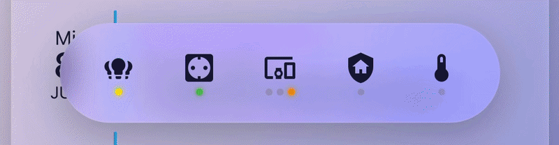

Hey everyone,
I built with help from AI a bottom navbar card with an iOS-26-style "liquid glass" lens that
follows your finger as you drag across the bar — plus per-route status
dots and live-templated icon colors. Wanted to share it in case it's
useful to anyone else.
What it does:
  • A frosted glass lens tracks your finger as you swipe across the bar,
    with a soft light-refraction fringe at the edges
  • Icons switch popups live as the lens passes over them — no need to
    lift your finger, just drag and let go on whatever you want
  • Optional colored status dots per route (e.g. "is any vacuum running?"),
    each driven by its own JS template against live entity states
  • Same templating for icon color itself
  • Light haptic pulse as the lens crosses into a new icon (native on the
    Companion App, navigator.vibrate fallback in-browser)
  • Theme-aware icon color (light/dark)
Built and tested against a sections-type dashboard, alongside Bubble
Card pop-ups as navigation targets (hash-based navigation, so it should
work with any hash-driven popup system, not just Bubble Card).
Honest limitation: it's blur/saturation/brightness plus a bit of
faked chromatic fringing to suggest glass refraction — true pixel-level
distortion (feDisplacementMap) didn't render reliably in the Companion
App's WebView when I tested it, so I dropped it rather than ship
something that only half-works.
GitHub: GitHub - donsebby/liquid-lens-navbar-card · GitHub
Install via HACS as a custom repository (category: Dashboard), or manual
install — instructions in the README.
Happy to hear feedback / ideas, and if anyone finds bugs, issues on the
repo are open.
