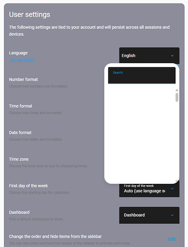

I’m certain that the text that shows up in the dropdown menus is primary-text-color. However, I have it set to white, which means I can’t see any of that text unless I identify the right variable(s) for a contrasting background.

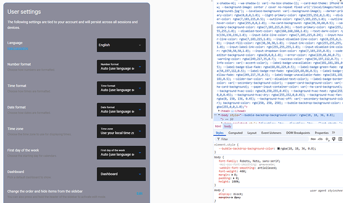

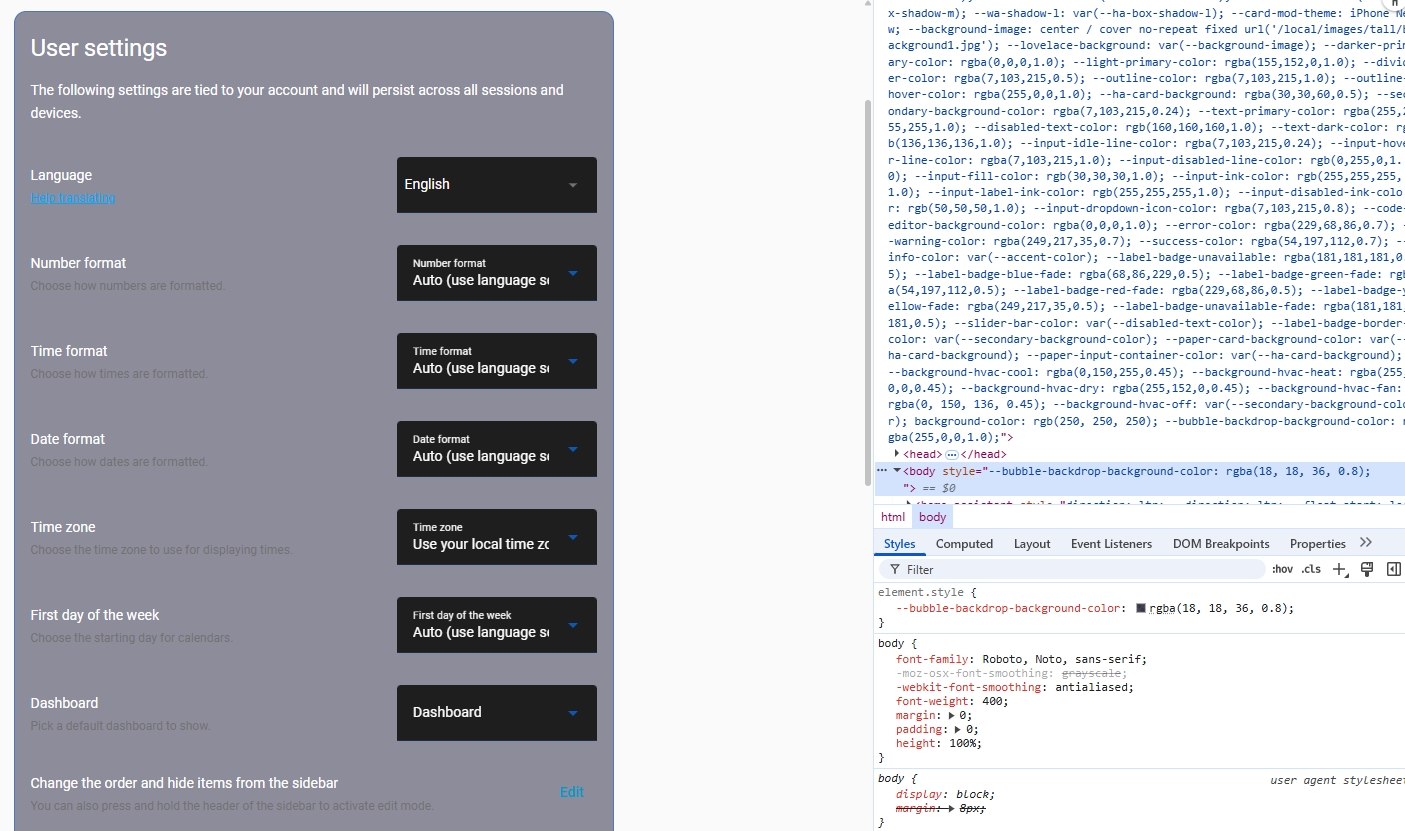

Going back to my immediate issue, this is what I see when I visit my profile page and hit F12 (using Chrome):
Now… I don’t know what I’m looking at. And clicking around the page doesn’t change the contents of the Styles tab in the bottom right. The most worrisome of the current issues is that I can’t see the values in the drop-down menus, and clicking them only results in changing things I don’t want changed… e.g., I set my UI language to Afrikaans just now while trying to see if I could see the styling of the invisible selections in the Language drop-down. In doing so, I didn’t see anything of value in the Styles tab.
I could very well be doing this incorrectly. I’ve just gone down this road before, and I only occasionally find the variable names I’m seeking.

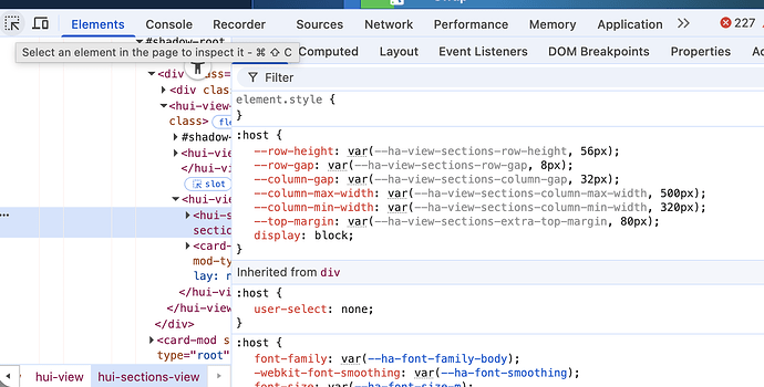

Did you select the right pointer in the toolbar?
in Chrome it looks like this (top left square with the arrow)
Safari has this icon in blue when selected.
after that, you can click any element in the view, and the Styling will scroll to that element

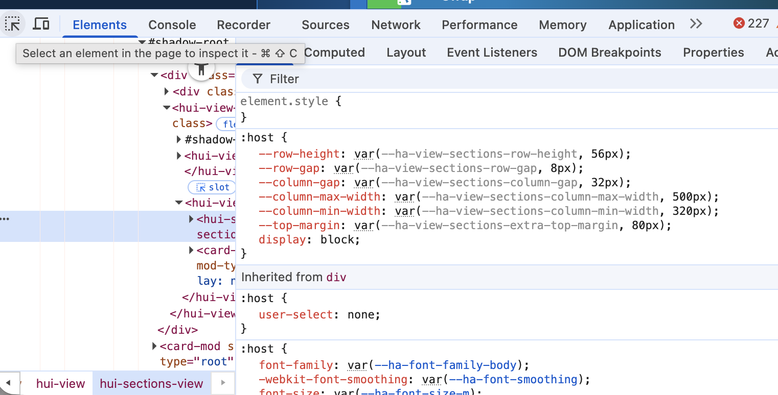

Thanks–that’s what I’ve been missing, and now I’m close. Now… once I click on this element (in this case, one of the selection item backgrounds), I see this:
I see the color (currently #FFFFFF) in the pop-up, and the top window on the right definitely jumps to that element in the page… but the Styles tab below isn’t revealing a variable name for the color.
I’m sure I’m close, but I’m not sure where to dig into to get that variable name from here. Thanks again.

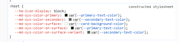

EDIT: If I scroll down in the Styles tab, I see this:
…but… md-sys-color-surface? Could that be it? Seems unlikely. Nope… that doesn’t do it.
EDIT 2: Ah hah… but that variable references card-background-color, which does effect that change. Great. I should be able to make some progress from here.
