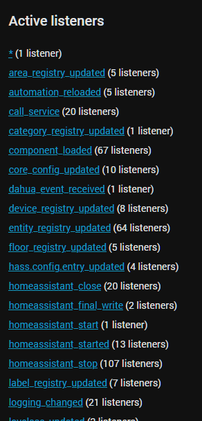

I’ve tried listening just for these events but can’t quite work out what I need to subscribe to.

AFAIK you can’t listen to a specific entity in devtools. You can only list to a type that is listed to the right in the event listener. e.g. call_service
If by chance you use nodered, you can isolate specific entities events using an events all node.

Great idea on using node-red; I hadn’t thought about that at all. All sorted now, thank you!
