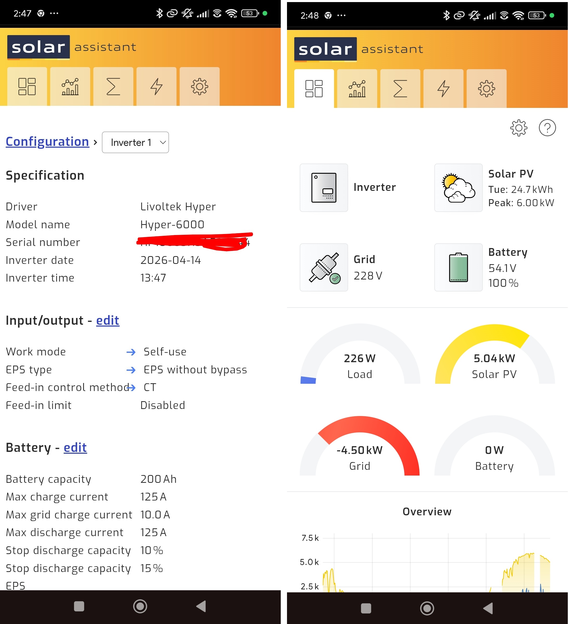

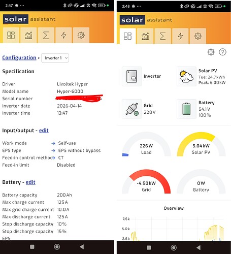

BTW Battery SoC in hass-livoltek integration started working yesterday morning. And stopped on evening…
And Solar Assistant!
Thanks to Anrich and Vince!
This is what they mentioned:
*"1. As you mentioned on the ticket in your last response, the only way to connect to the inverter is by using the same USB port that the dongle uses. We thoroughly confirmed this. *
*a) The dongle uses a USB plug & port, but is actually just RS485 and power. *
b) I will need to write the guide and explain the connection, and these options won’t be “just buy a cable”. It’ll be more custom, and the average user likely won’t go through the hassle. This is fine, the DIY crowd will still be able to do this (no need to solder/open the inverter, just some custom wiring)
2. Support will only become available in the next beta release - not sure how far out this is, but it should be in the next beta version.
So, it would be worth making note of those facts for other users. Just to set expectations and avoid users thinking the connection will be easier than it actually is, or people getting upset that they cannot see the protocol for the unit yet."
For now it`s just me and the guys at Solar Assistant testing the implementation.
