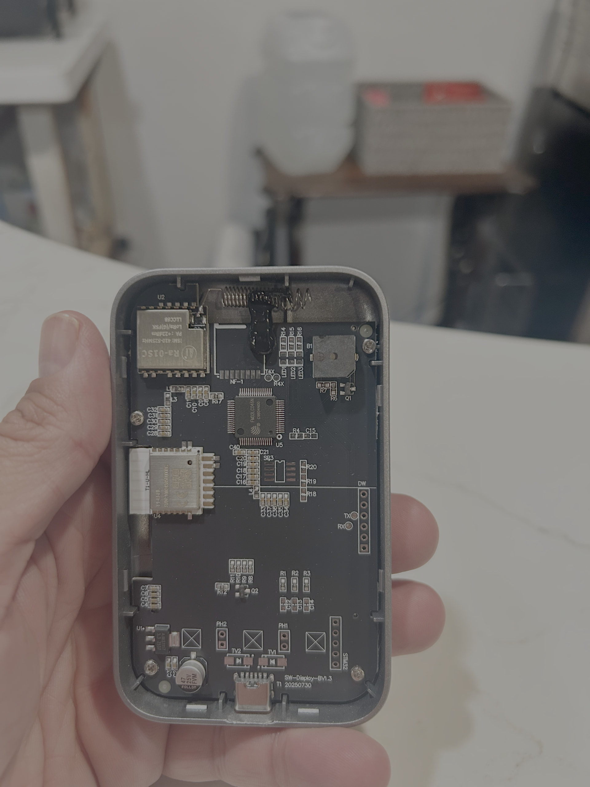

  • Display hub — the WiFi device. Contains a Tuya T1-U-HL WiFi/BLE module (FCC ID 2ANDL-T1-U-HL) and an Ai-Thinker Ra-01SC LoRa module (FCC ID 2ATPO-RA-01SC).
So from the network’s point of view it’s one Tuya WiFi device (the display); the LoRa probe is invisible and its readings are just republished as Tuya DPs. Only 4 of the “7” values are real sensors — TDS and salinity are derived from EC, and CL is calculated from ORP + pH, not measured.

The probe sits in the water and communicates via LoRa to a "display". The display connects to WiFi, and that is what the app talks to. The display also supports Bluetooth. It is a pretty sexy board:
