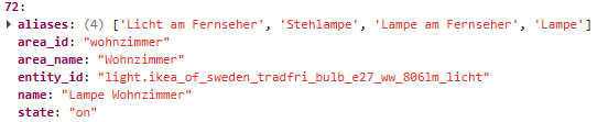

a couple of days ago I asked the voice assistant to turn up the light in the living room by 20%. This wasn’t processed locally through an intent, but instead by the LLM (I’m using Gemini 2.5 Flash via OpenRouter).
However, the light didn’t get brighter, so I checked the debugger of the conversation and couldn’t find any information about the state or brightness of the light. There is just a list of all exposed entities and their areas.
I tested other values, but the results are always more or less random. It seems that the LLM doesn’t know about the brightness of the light.
My first question: is there a way to see all the information that is sent to the LLM via the system context prompt?
Since I’m testing with n8n and the Webhook Conversation integration, I made the same request to my local n8n workflow and checked the incoming system prompt in n8n. In this system prompt there is more information for each exposed entity, but for my light only the current state “on” is included.
I’m using a lot of Zigbee devices and some of the lights are dimmable, so they have a brightness attribute.
Am I doing something wrong that prevents the brightness attribute from being added to the system context prompt, or is anyone else experiencing this issue?

The LLM needs to call the get_live_context tool to retrieve the current status of entities.
The Assist service doesn’t provide these into the main system prompt as they are not static, and can change regularly. When something changes in your system prompt, this breaks the prompt cache at that point of the prompt and forces all subsequent sections of the prompt to be re-processed - including the very large tooling definitions that are typically inserted AFTER the system prompt itself by the models template when it compiles the request to be processed.
Basically, having dynamic content in your prompt results in a large bump in TTFT (time to first token). The con to removing it though is that your model doesn’t know the status of anything until it calls a tool to retrieve it. They did this with the date/time as well, which was previously in the system prompt, and extracted it out to be accessed via a tool.
Try giving your model directives in its prompt to call the live context tool first in cases where you are asking it to adjust something by a certain percent.
