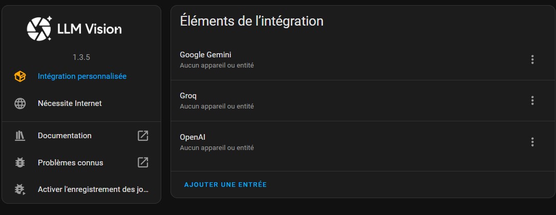

I need help because I can’t do it or I misunderstood my camera works with frigate and a coral; the direction is the following image_file: /config/media/frigate/clips/ (except that the images are random) example (frigate1-1735750557.182234-2cehsy.jpg) and then I’m missing the frigate tap action url to navigate on my ios mobile
help please

How did you get openrouter to work with it?
I tried with the “https://openrouter.ai/api/v1/chat/completions” endpoint and it lets me add it as a Custom provider, but I’m getting errors when I try to use it instead of the OpenAI API which works flawlessly.
