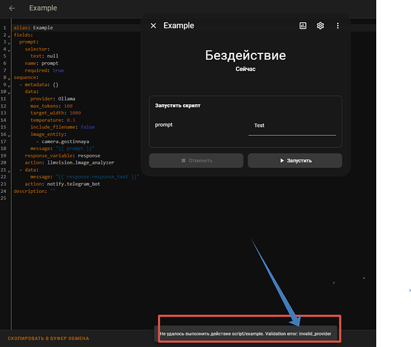

I followed this instruction step by step, it is clear and well written. Ollama is installed locally and added to the Home Assistant. Added the minicpm-v model. Communication with her through the assistant in the Home Assistant is working. But when creating any script to get a description, an error appears.
