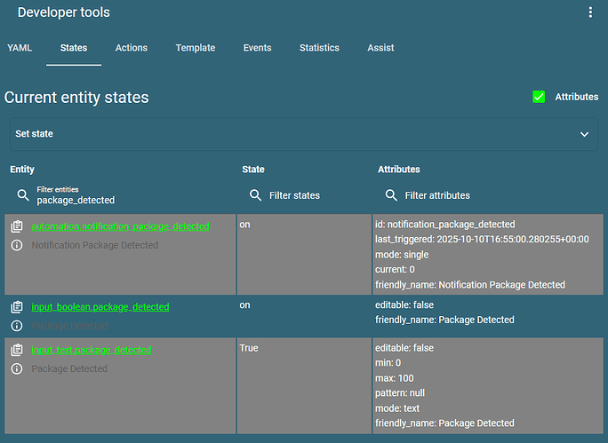

When I ditched Ring for ReoLink cameras I really missed the notifications for packages on my porch. Thanks to this thread and community, I was able to automate my own!
To say thank you :clap:, and because I feel it’s my duty to give back, here’s my automation:
  • id: notification_package_detected
    alias: Notification Package Detected
    trigger:
    • platform: state
      entity_id: binary_sensor.doorbell_person
      to: ‘on’
    • platform: time_pattern
      minutes: ‘/20’
    action:
    sequence:

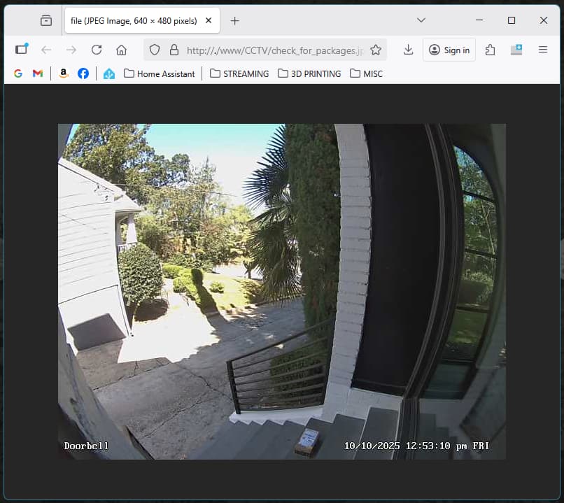

TAKE CAMERA SNAPSHOT
  - delay: '00:01:00'
  - service: camera.snapshot
      entity_id: camera.doorbell_fluent
      filename: "/config/www/CCTV/check_for_packages.jpg"
  - delay: '00:00:05'
CHECK CAMERA IMAGE FOR PACKAGES
  - metadata: {}
      prompt: >
        There is a package on or near the steps. Answer as one word: True or False.
      filenames: "/config/www/CCTV/check_for_packages.jpg"
    response_variable: generated_content
    action: google_generative_ai_conversation.generate_content

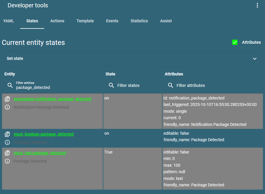

SET PACKAGE STATUS TO TRUE OR FALSE
  - metadata: {}
    action: input_text.set_value
      value: "{{ generated_content['text'] }}"
      entity_id: input_text.package_detected
TOGGLE INPUT BOOLEAN
  - service_template: >
      {% if is_state('input_text.package_detected', 'True') %}
      input_boolean.turn_on
      {% else %}
      input_boolean.turn_off
      {% endif %}
    entity_id: input_boolean.package_detected

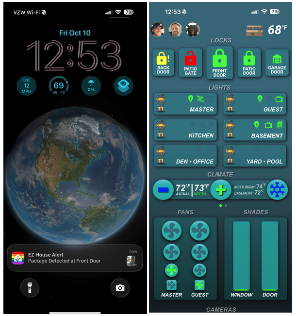

SEND IOS NOTIFICATION
  - metadata: {}
      title: EZ House Alert
      message: Package Detected at Front Door
        image: '{{ filename }}'
    action: >
      notify.mobile_app_zachs_iphone
      {% endif %}
mode: single
Thank you! :sparkling_heart:
