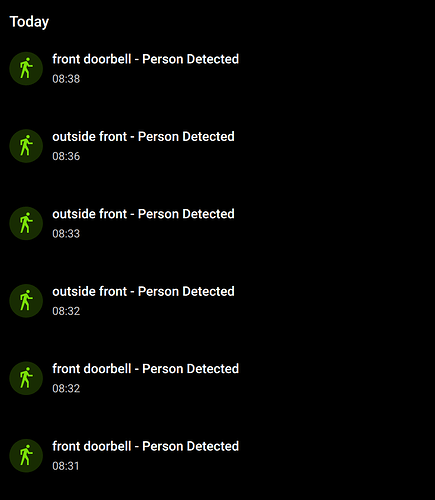

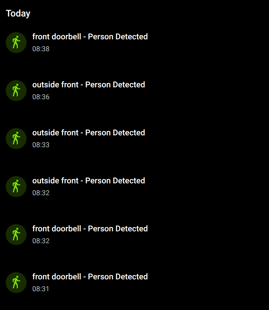

But I’m wanting to create an event when frigate gets a new image, i’ve got the mqtt hooked up and the trigger part of the automation is working
Blockquote
- service: llmvision.create_event
title: "{{ trigger.payload_json[‘after’][‘camera’] | replace(‘_’, ’ ') }} - Person Detected "
description: “No AI Processing Yet”
category: “people”
image_file: “media-source://frigate/{{ trigger.payload_json[‘after’][‘camera’] }}/event/{{ trigger.payload_json[‘after’][‘id’] }}/snapshot.jpg”
But the image doesn’t seem to be created in the LLM vision folder. I can see from the media page that home assistant can see the snapshots, and that if i generate a local url to view the snapshot in browser that works too
