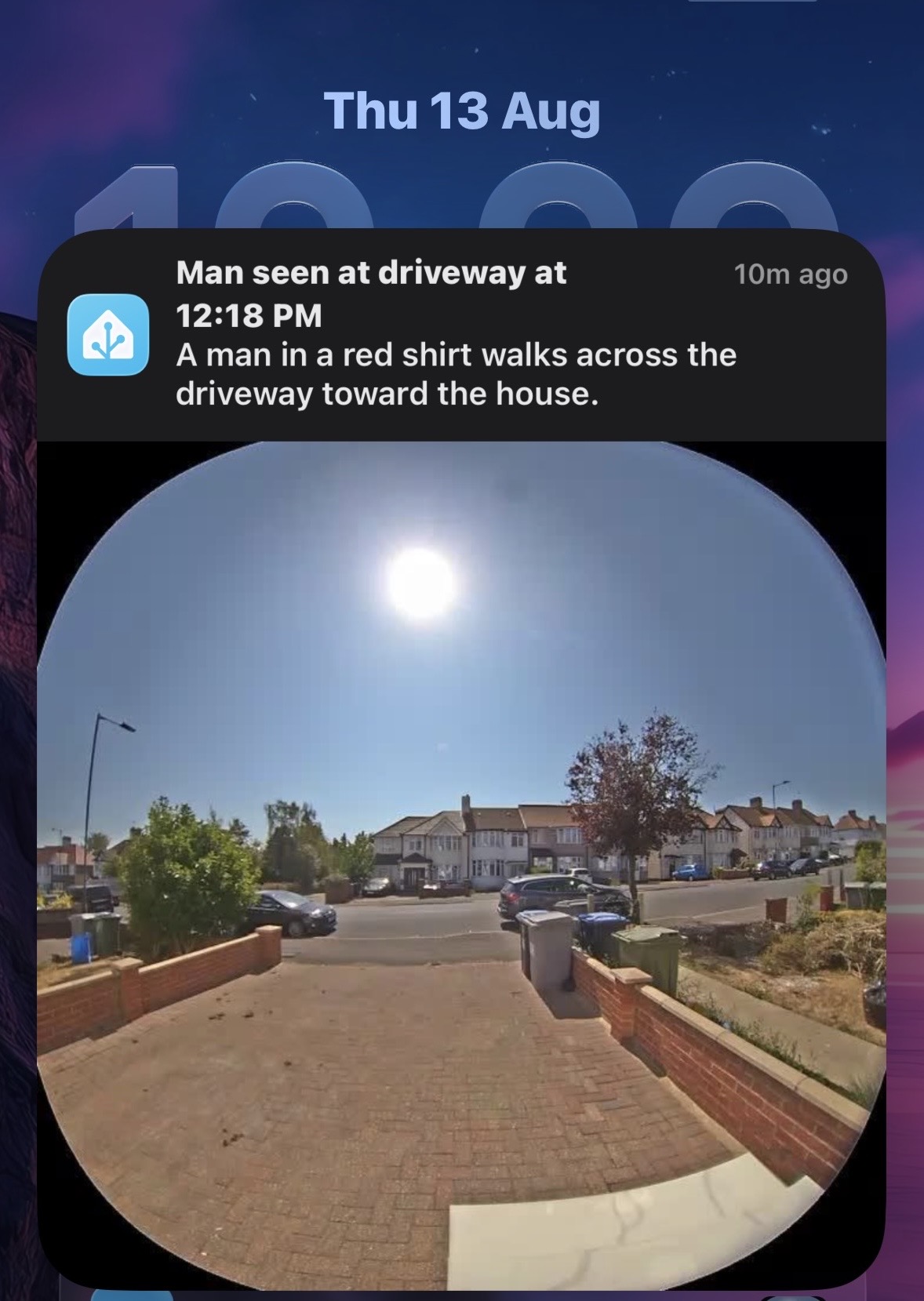

I’m trying to use LLM-Vision with two Ring cameras and one Reolink camera.
When motion is detected, I receive an AI notification along with a snapshot.
The AI even correctly identifies the person by name.
However, while the Reolink snapshot clearly shows the person in the notification and on the Timeline, the Ring camera snapshots do not show anyone at all.
For instance, when my Ring Floodlight Cam detects motion, the AI reports that “John is approaching,” but the attached snapshot just shows an empty garden, with no person visible.
From what I’ve researched, this seems to be related to the Ring Cloud service. Has anyone else experienced this issue? And does anyone know of a fix?

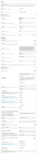

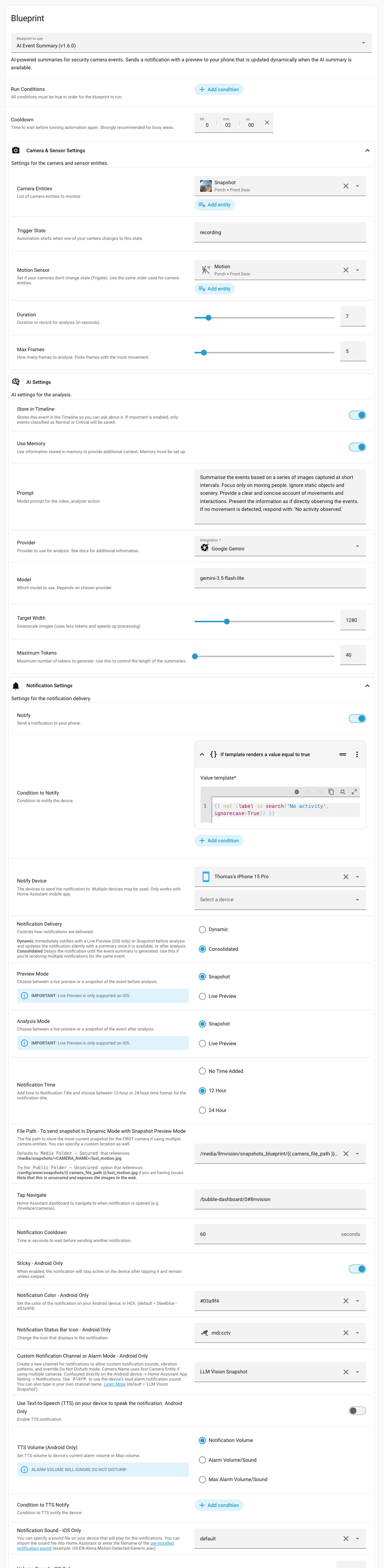

How to use the blueprint with cameras with multiple AI sensors?
reolink integration exposes its cameras not having any state. it exposes a pet, person, vehicle, and motion sensors for each camera. how do I use these sensors for just one camera?
Current blueprint only allows one sensor for a camera.

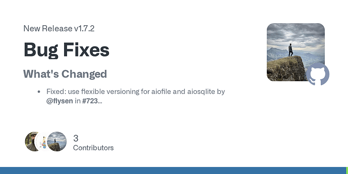

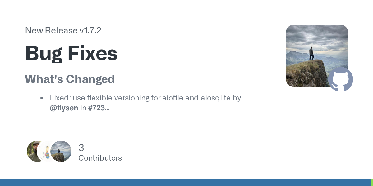

Logger: homeassistant.setup
Source: setup.py:276
First occurred: 16:22:00 (1 occurrence)
Last logged: 16:22:00
Setup failed for custom integration ‘llmvision’: Requirements for llmvision not found: [‘aiofile==3.9.0’].
llmvision won’t load, anyone have the same issue
Hi Chykan,
I ran into the same issue. The issue was fixed in 1.7.2. You can redownload the llmvision integration in HACS and select latest.
Thanks @tainoking
