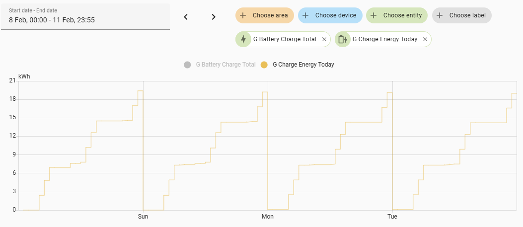

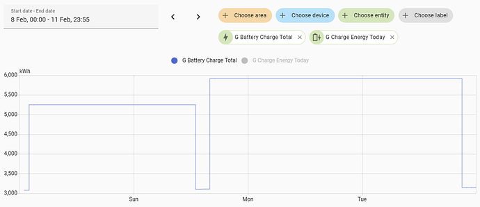

As explained in the HA article, ‘measurement over time’ entities have a ‘state’ value and a ‘sum’ value, captured every hour in the LTS (and every 5 minutes in the STS). The Energy dashboard uses the ‘sum’ figures whereas a history graph uses the ‘state’ figures so usually both need to be updated to ensure the LTS and any graphs you want to look at can be used everywhere in HA.
To show how to adjust LTS I will use some real examples of my own, starting with from 21:00 on 19th January through to 22:00 on 20th January where HA stopped recording my Long Term Statistics.

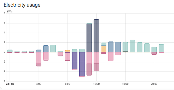

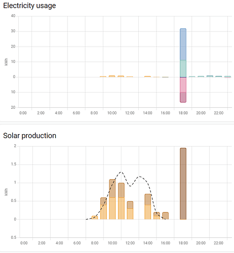

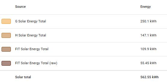

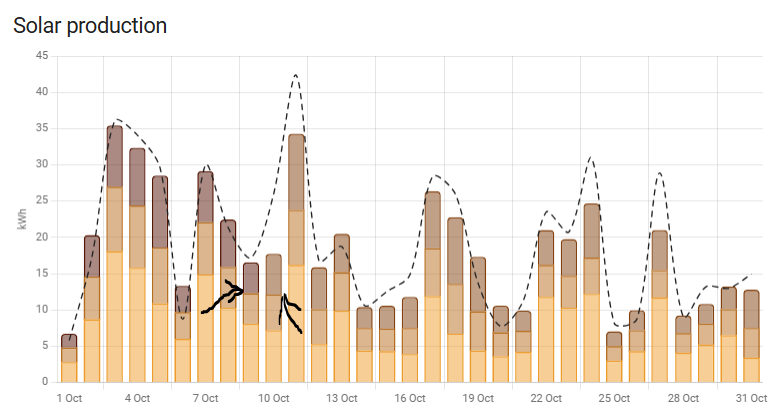

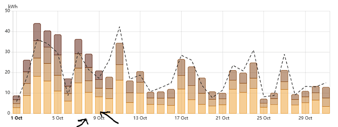

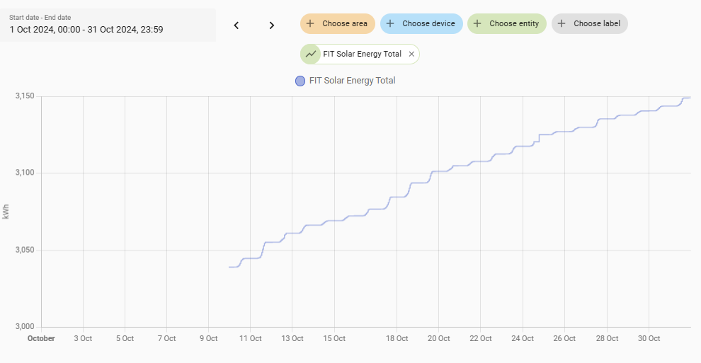

In the Energy dashboard you can see that the the FIT solar, import, battery charge and discharge all appear as single big lump sums at 6pm which is when I got the statistics collection working again.
Solar G and H appear correctly hour by hour (but that’s only because I had manually entered the stats for each hour of the day). The methods laid out below make this a lot easier and quicker.

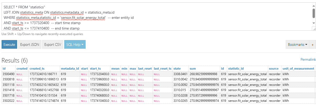

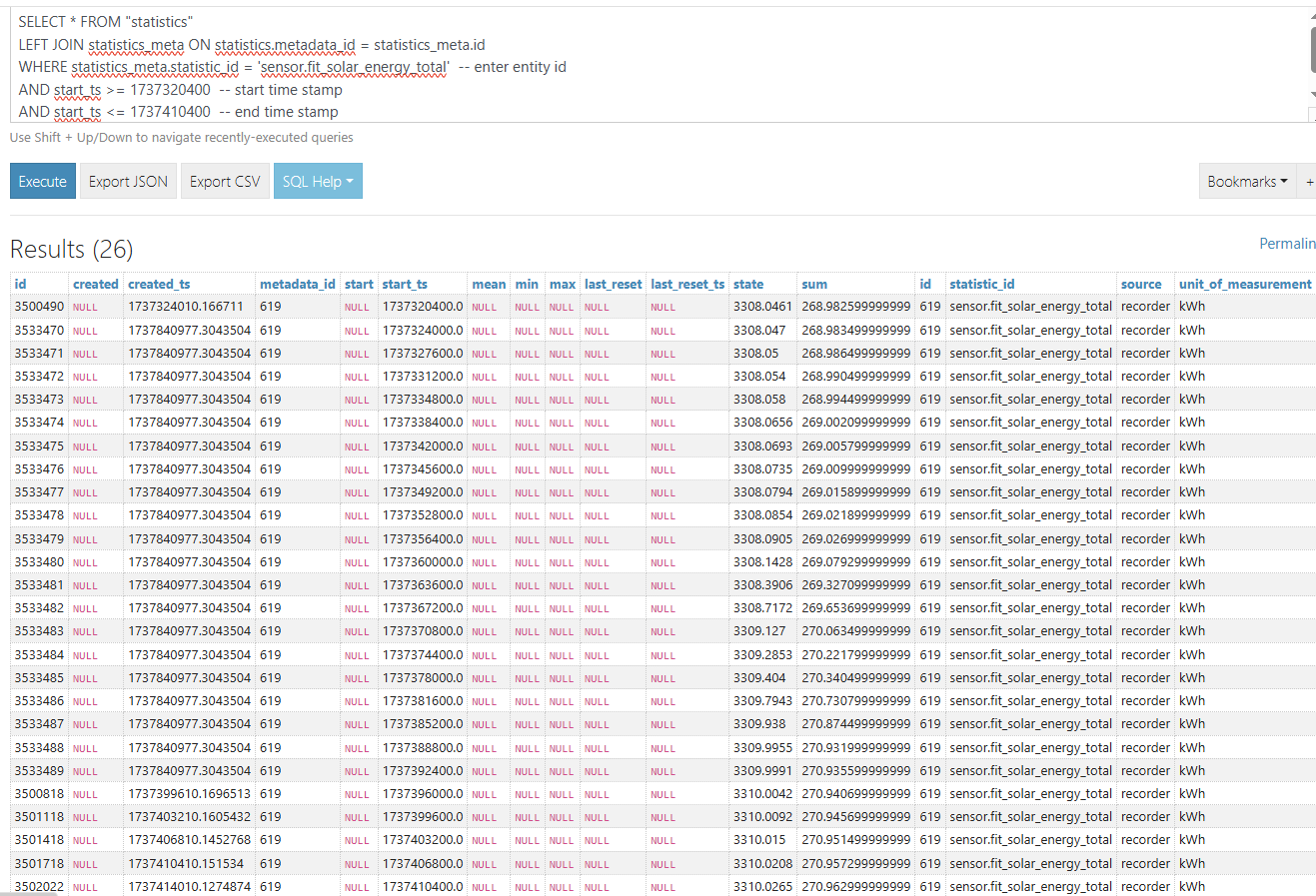

  1. Query the existing LTS for the range of records we are going to be updating.
SQLweb add-on. Paste in the following query, substituting your own entity id, start and end timestamps (from above step):
SELECT * FROM statistics
LEFT JOIN statistics_meta ON statistics.metadata_id = statistics_meta.id
WHERE statistics_meta.statistic_id = 'sensor.fit_solar_energy_total'  -- entity id
AND start_ts >= 1737320400  -- start time stamp
AND start_ts <= 1737410400  -- end time stamp
ORDER BY start_ts
You should get a result set looking something like this. In my case as recorder wasn’t running there are very few records.
We need to make a note of the ‘sum’ value corresponding to the start time (first) record. In my case is it 268.982599999.

  1. View the updated statistics by re-running the query from step 5 above, developer tools/statistics or viewing the energy dashboard

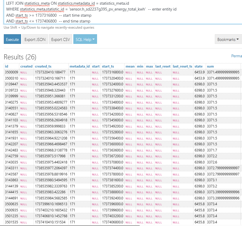

WHERE statistics_meta.statistic_id = 'sensor.givtcp_INVID_pv_energy_total_kwh'  -- entity id
AND start_ts >= 1737316800 -3600  -- start time stamp minus 1 hour before
AND start_ts <= 1737406800        -- end time stamp
ORDER BY start_ts
We need to make a note of the ‘sum’ and ‘state’ values from the first record - this is the LTS record an hour immediately before the start time record. In my case they are 3371.5 and 6453.9 respectively.
If you want to convert the date/time of any of the records to printable format, copy the start_ts into this developer tools/template code fragment:
{% set x=1737320400.0 %}
{{x|timestamp_custom('%Y-%m-%d %H:%M')}}

  1. View the updated statistics by re-running the query from step 4 above, viewing the energy dashboard and looking at the entity state history in the history graph for the selected date/time period.
  2. Dealing with additional Energy dashboard spike after the loaded history
Having followed the above process and successfully loaded the entity state and sum, it may well be that there is a new spike showing in the Energy dashboard that appears immediately after the history load. This is due to the sum value not incrementing correctly across the transition from the replaced history to the existing history records.
I had this problem with my battery charge, discharge and grid import sensors, and is best seen by looking at the data through SQL web.
Repeat the SQL query from step 4 but expand the ‘start_ts where clauses’ to include a few more records either side, i.e.:
WHERE statistics_meta.statistic_id = 'sensor.grid_import_today_day'  -- entity id
AND start_ts >= (1737316800 - (3*3600)) -- start time stamp minus 3 hours
AND start_ts <= (1737406800 + (3*3600)) -- end time stamp plus 3 hours
ORDER BY start_ts
(The +/- 3*3600 adds 3 extra hours before the start time and 3 after the end time as each start_ts is 3600 apart from the next record)
This shows the LTS records before the history restore, the records loaded by the import_statistics integration, and a few afterwards.
e.g.:
id	created	created_ts	metadata_id	start	start_ts	mean	min	max	last_reset	last_reset_ts	state	sum	id	statistic_id	source	unit_of_measurement	has_mean	has_sum	name
[existing LTS records immediately before the history load:]
3499332	NULL	1737313210.1869912	32	NULL	1737309600.0	NULL	NULL	NULL	NULL	NULL	45.4	11686.6	32	sensor.grid_import_today_day	recorder	kWh	0	1	NULL
3499633	NULL	1737316810.142873	32	NULL	1737313200.0	NULL	NULL	NULL	NULL	NULL	48.7	11689.9	32	sensor.grid_import_today_day	recorder	kWh	0	1	NULL
3499934	NULL	1737320410.188477	32	NULL	1737316800.0	NULL	NULL	NULL	NULL	NULL	52.2	11693.4	32	sensor.grid_import_today_day	recorder	kWh	0	1	NULL
[LTS records loaded by the integration:]
3139369	NULL	1738535943.438116	32	NULL	1737324000.0	NULL	NULL	NULL	NULL	NULL	62.0	11703.2	32	sensor.grid_import_today_day	recorder	kWh	0	1	NULL
3139645	NULL	1738535948.3166165	32	NULL	1737327600.0	NULL	NULL	NULL	NULL	NULL	67.5	11708.7	32	sensor.grid_import_today_day	recorder	kWh	0	1	NULL
1	NULL
3139921	NULL	1738535951.3493242	32	NULL	1737331200.0	NULL	NULL	NULL	NULL	NULL	3.6	11712.3	32	sensor.grid_import_today_day	recorder	kWh	0	1	NULL
3140197	NULL	1738535953.4728782	32	NULL	1737334800.0	NULL	NULL	NULL	NULL	NULL	6.4	11715.1	32	sensor.grid_import_today_day	recorder	kWh	0	1	NULL
3500860	NULL	1737403210.1605432	32	NULL	1737399600.0	NULL	NULL	NULL	NULL	NULL	35.1	11743.8	32	sensor.grid_import_today_day	recorder	kWh	0	1	NULL
3501160	NULL	1737406810.1452768	32	NULL	1737403200.0	NULL	NULL	NULL	NULL	NULL	35.1	11743.8	32	sensor.grid_import_today_day	recorder	kWh	0	1	NULL
3501460	NULL	1737410410.151534	32	NULL	1737406800.0	NULL	NULL	NULL	NULL	NULL	35.4	11744.1	32	sensor.grid_import_today_day	recorder	kWh	0	1	NULL
[existing LTS records that are immediately after the history load:]
3501764	NULL	1737414010.1274874	32	NULL	1737410400.0	NULL	NULL	NULL	NULL	NULL	35.6	11708.0	32	sensor.grid_import_today_day	recorder	kWh	0	1	NULL
3502066	NULL	1737417610.1580782	32	NULL	1737414000.0	NULL	NULL	NULL	NULL	NULL	35.8	11708.2	32	sensor.grid_import_today_day	recorder	kWh	0	1	NULL
3502369	NULL	1737421210.1547968	32	NULL	1737417600.0	NULL	NULL	NULL	NULL	NULL	0.5	11708.7	32	sensor.grid_import_today_day	recorder	kWh	0	1	NULL
As explained in scenario 5 below, sum is initialised to zero when the entity is first created and increments forever upwards as state increments, whereas on a ‘today’ entity, state is reset to zero at the start of each day. Because there has been a problem with the statistics, this consistency is broken.
Looking at the records before and during the inserted history, state increments each hour, gets up to 67.5 (at midnight), then at the end of the next hour (1am) having been reset to zero at midnight, is 3.6. Sum increments each hour by the difference between the state value and the previous state value (ignoring the reset to zero).
The problem comes at the end, the last history record we inserted has state 35.4 and sum 11744.1, the first after the insertion the state is now 35.6 (i.e. 0.2 more) but sum drops down to 11708.0 whereas it should be 11744.3 (i.e. 0.2 more than the prior LTS record). Thereafter state and sum increment together properly, the next record has state 35.8 and sum is 11708.2, both 0.2 more than the prior record.
The fix we need to apply (borrowing from the techniques in scenarios 5 and 7 below) is to adjust sum to bring it into line with state by adding 11744.1 - 11708.0 + 0.2 = 36.3 to the first record after the history insertion and every record thereafter (because they will all be wrong by this delta amount):
UPDATE statistics_short_term
SET sum = sum + 36.3 -- add adjustment factor to correct for additional entity reset
WHERE metadata_id = 32          -- metadata_id is of the entity being updated
AND start_ts >= 1737410400.0	-- start_ts is the time of the first record where the sum needs to be adjusted
and statistics:
UPDATE statistics
As the LTS are created from the STS, make sure that both tables are updated with any corrections and statistics_short_term is updated first.
SQLweb add-on. Paste in the following query, substituting your own entity id, start and end timestamps (from step 2):
WHERE statistics_meta.statistic_id = 'sensor.grid_import_today_day_cost_2'  -- entity id
AND start_ts <= 1737414000  -- end time stamp
ORDER BY start_ts
You should get a result set looking something like this:
3500222	NULL	1737324010.166711	7	NULL	1737320400.0	NULL	NULL	NULL	NULL	1737244800.092167	14.3084	1850.3616	7	sensor.grid_import_today_day_cost_2	recorder	GBP	0	1	NULL
3139356	NULL	1738535943.4376893	7	NULL	1737324000.0	NULL	NULL	NULL	NULL	1734048000.016701	11.3379	1851.5636	7	sensor.grid_import_today_day_cost_2	recorder	GBP	0	1	NULL
3139632	NULL	1738535948.3159373	7	NULL	1737327600.0	NULL	NULL	NULL	NULL	1734048000.016701	11.3379	1852.7736	7	sensor.grid_import_today_day_cost_2	recorder	GBP	0	1	NULL
3139908	NULL	1738535951.3488548	7	NULL	1737331200.0	NULL	NULL	NULL	NULL	1734048000.016701	11.3379	1852.7736	7	sensor.grid_import_today_day_cost_2	recorder	GBP	0	1	NULL
3140184	NULL	1738535953.4722095	7	NULL	1737334800.0	NULL	NULL	NULL	NULL	1734048000.016701	11.3379	1852.7736	7	sensor.grid_import_today_day_cost_2	recorder	GBP	0	1	NULL
3140460	NULL	1738535955.0181875	7	NULL	1737338400.0	NULL	NULL	NULL	NULL	1734048000.016701	11.3379	1852.7736	7	sensor.grid_import_today_day_cost_2	recorder	GBP	0	1	NULL
3500847	NULL	1737403210.1605432	7	NULL	1737399600.0	NULL	NULL	NULL	NULL	1737389883.640885	0.09999	1852.76999	7	sensor.grid_import_today_day_cost_2	recorder	GBP	0	1	NULL
3501147	NULL	1737406810.1452768	7	NULL	1737403200.0	NULL	NULL	NULL	NULL	1737389883.640885	0.09999	1852.76999	7	sensor.grid_import_today_day_cost_2	recorder	GBP	0	1	NULL
3501447	NULL	1737410410.151534	7	NULL	1737406800.0	NULL	NULL	NULL	NULL	1737389883.640885	0.17606	1852.84606	7	sensor.grid_import_today_day_cost_2	recorder	GBP	0	1	NULL
3501751	NULL	1737414010.1274874	7	NULL	1737410400.0	NULL	NULL	NULL	NULL	1737389883.640885	0.22060	1852.89060	7	sensor.grid_import_today_day_cost_2	recorder	GBP	0	1	NULL
3502053	NULL	1737417610.1580782	7	NULL	1737414000.0	NULL	NULL	NULL	NULL	1737389883.640885	0.26514	1852.9351	7	sensor.grid_import_today_day_cost_2	recorder	GBP	0	1	NULL
What we should see is state incrementing by the £ import value each hour until it gets to 23:00, and then the next record (midnight) it starts back from zero again. Sum should increment forever from when the sensor was first created.
This doesn’t happen for my data, state increases, gets stuck at 11.3379, then resets to zero in the middle of a day. Sum looks like it is incrementing correctly.
We need to make a note of the ‘state’ and ‘sum’ values corresponding to the start time of the first record (which we know is OK). In my case they are 14.3084865 and 1850.361639000002 respectively.

  1. Dealing with additional Energy dashboard spike after the loaded history
After loading the missing statistics history from Octopus, its likely that there will be a new spike showing in the Energy dashboard immediately after where the LTS has been loaded. This is due to the sum value not incrementing correctly across the transition from the replaced history to the existing history records.
This is best seen by looking at the data through SQL.
AND start_ts >= 1737320400 - (3*3600)  -- start time stamp less 3 hours
AND start_ts <= 1737414000 + (3*3600)  -- end time stamp plus 3 hours
ORDER BY start_ts
(The +/- 3*3600 adds 3 extra records before the start time and 3 after the end time as each start_ts is 3600 apart from the next record)
This shows the LTS records before the history restore, the records loaded by the import_statistics integration, and a few afterwards. We need to focus on the records at the end.
e.g.:
3501447	NULL	1737410410.151534	7	NULL	1737406800.0	NULL	NULL	NULL	NULL	NULL	11.530365	1864.318239	7	sensor.grid_import_today_day_cost_2	recorder	GBP	0	1	NULL
3501751	NULL	1737414010.1274874	7	NULL	1737410400.0	NULL	NULL	NULL	NULL	NULL	11.580345	1864.368219	7	sensor.grid_import_today_day_cost_2	recorder	GBP	0	1	NULL
3502053	NULL	1737417610.1580782	7	NULL	1737414000.0	NULL	NULL	NULL	NULL	NULL	11.629905	1864.417779	7	sensor.grid_import_today_day_cost_2	recorder	GBP	0	1	NULL
3502356	NULL	1737421210.1547968	7	NULL	1737417600.0	NULL	NULL	NULL	NULL	1737417600.051562	0.115878	1853.051024	7	sensor.grid_import_today_day_cost_2	recorder	GBP	0	1	NULL
3502659	NULL	1737424810.1311069	7	NULL	1737421200.0	NULL	NULL	NULL	NULL	1737417600.051562	0.246036	1853.1812	7	sensor.grid_import_today_day_cost_2	recorder	GBP	0	1	NULL
3502962	NULL	1737428410.154108	7	NULL	1737424800.0	NULL	NULL	NULL	NULL	1737417600.051562	0.793947	1853.7291	7	sensor.grid_import_today_day_cost_2	recorder	GBP	0	1	NULL
Looking at the records before and during the inserted history, state increments each hour, gets up to 11.629905 (at midnight), then at the end of the next hour (1am) having been reset to zero at midnight, is 0.115878.
Sum increments each hour by the difference between the state value and the previous state value (ignoring the reset to zero) but at the point of transition sum drops from 1864.417779 (loaded by the integration) to 1853.051024 (original LTS value) whereas it should be 1864.417779 (prior record value) + 0.115878 (state change in the first hour).
This jump in value causes a spike in the Energy dashboard on the day after the history load (21/1/24). In my case, as its the import cost that spikes, showing that for 49.6kWh of import it only cost £1.78 - as if!
On subsequent records after the transition point state and sum increment together properly, the next record has state 0.246036 and sum is 1853.1812, both 0.130176 more than the prior record.
The fix we need to apply (borrowing from the techniques in scenarios 5 and 7) is to adjust sum to bring it into line with state by adding 1864.417779 - 1853.051024 + 0.115878 = 11.482633 to the first record after the history insertion and every record thereafter (because they will all be wrong by this delta amount):
You must update statistics_short_term first as the statistics table is built from aggregating statistics_short_term, and if statistics_short_term isn’t corrected then future statistics records written will have the wrong sum value.

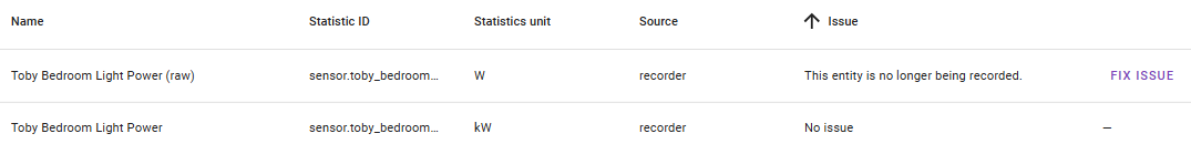

In this example we already have the statistics in HA but they are on the on the wrong entity and need migrating from one entity to another. There are a number of reasons how this might occur, you replace one device with another, you introduce a filter sensor to reduce storage in the HA database for ‘noisy’ sensors, etc, etc.
It could be possible to extract the existing LTS from one entity into a file, reformat it and then use import_statistics to load the data into the new entity, but instead since the data is already in the LTS database tables we are going to migrate it from one entity to another using techniques similar to as described in Migrate energy statistics from one entity to another
[NB: I haven’t tried to develop a procedure to extract LTS into a file and then use import_statistics to reload it, principally because as already noted, LTS holds dates in Unix seconds since 1970 format and import_statistics needs printable dates. Working out how to convert one to the other en-mass seemed non trivial so isn’t something I have looked further at]
You absolutely must take a backup beforehand !
The example I am going to use is my FIT Solar Energy Total sensor that I replaced with a time_throttle filter sensor that collects the data every minute instead of every state change measured by the CT clamp on my FIT inverter output.
In the Energy dashboard I added the old and new FIT total energy sensors so there was no break in the history in the dashboard:
And you can just about see the different shade of brown in the dashboard as I made the change on the 9th October:
And in the entity history, FIT solar energy total starts from 9th October:
I need to migrate ALL the LTS from sensor.fit_solar_energy_total_raw to sensor.fit_solar_energy_total. The procedures below describe the steps to be followed for an entity of state_class ‘total’ or ‘total_increasing’ and are the same regardless of whether the sensor is a ‘total’, ‘today’, ‘monthly’ or utility meter entity.

  1. View the LTS for the NEW destination entity we are migrating TO
WHERE  metadata_id = (SELECT id
                      FROM   statistics_meta
                      WHERE  statistic_id = 'sensor.fit_solar_energy_total')  -- 'new' destination entity id that is being migrated to
ORDER BY start_ts
(add a WHERE start_ts <= or >= if necessary to target specific date/time ranges)
The first records are:
2682272	NULL	1728514811.3689609	619	NULL	1728511200.0	NULL	NULL	NULL	NULL	NULL	3039.064	0.0005
2682581	NULL	1728518410.4455652	619	NULL	1728514800.0	NULL	NULL	NULL	NULL	NULL	3039.067	0.0035
2682888	NULL	1728522011.1162825	619	NULL	1728518400.0	NULL	NULL	NULL	NULL	NULL	3039.07	0.0065
Again for the entity we are migrating to, note the destination metadata_id (619), the state (3039.064) and (for total or total_increasing entities) the sum (0.0005) of the first record.
Can see that the last record from the source entity and the first record for the destination entity have the same start_ts (1728511200.0) so when migrating we need to not migrate that record across as we will get a duplicate violation if we do.
For total and total_increasing entities we can see that whilst the state increments correctly from the old to the new entity, the sum started back at zero when the new (destination) entity was created so we will need to adjust the sum value of all the existing statistics for the destination entity to avoid getting a ‘jump’ in entity values (which shows up in the Energy dashboard).
Whilst looking at the new entity, page through all the records and check if there are any occasions where the state resets back to zero. If there is, there’s some additional activity that will be needed to be done (see point 8 below).

  1. Check the Energy dashboard and the target entity history:
In the Energy dashboard, up to the migration date (8th October) there are (in my case) four solar sources, my two GivEnergy arrays, the new FIT sensor and the original FIT (raw) sensor. The FIT and FIT raw (top two bars) have the same values.
After 9th October only the new FIT sensor is being populated, FIT raw stopped being populated so has no data shown on the energy dashboard:
The energy sources show the FIT Solar Energy Total (that was 109.45kWh) is now increased by 55.45kWh, the FIT raw history that has been migrated across.

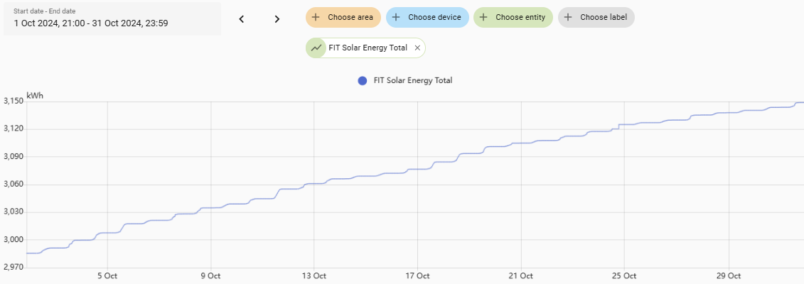

The FIT solar entity history now is a smooth line going all the way back in time:

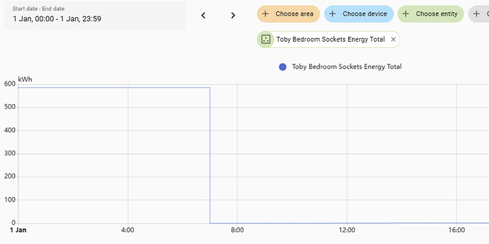

  1. Extra step if state or sum resets to zero
The above technique worked perfectly for migrating my FIT entity history from the source sensor to the destination. However when migrating another entity history I found a problem in a couple of sensors where the destination entity state had randomly reset itself back to zero:
And can see this in the statistics for that entity:
3364594	NULL	1735686010.4762971	620	NULL	1735682400.0	NULL	NULL	NULL	NULL	NULL	585.4702	585.47
3364898	NULL	1735689610.446479	620	NULL	1735686000.0	NULL	NULL	NULL	NULL	NULL	585.6163	585.6161
3365202	NULL	1735693210.4731658	620	NULL	1735689600.0	NULL	NULL	NULL	NULL	NULL	585.7252	585.725
3365506	NULL	1735718410.3739939	620	NULL	1735714800.0	NULL	NULL	NULL	NULL	NULL	0.1006	585.8254
3365806	NULL	1735722010.3142457	620	NULL	1735718400.0	NULL	NULL	NULL	NULL	NULL	0.1136	585.8384
3366106	NULL	1735725610.3938053	620	NULL	1735722000.0	NULL	NULL	NULL	NULL	NULL	0.1243	585.8491

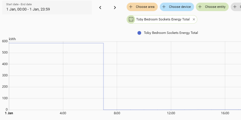

sum keeps incrementing properly but state resets back to zero.
This is a bit annoying but can’t do anything about it as the state value is provided by the source device and we can’t change that, but a jump in state doesn’t cause a problem in the Energy dashboard as that relies on the changes in sum to show energy consumption.
As long as sum keeps incrementing properly then there is nothing more needed to be done.
If however sum doesn’t increment properly then you might need to adjust it:
Make a note of start_ts of the record where the sum value jumps (e.g. 1735714800.0) and the sum of the prior record (585.7252). Subtract the difference between sum values either side of the jump.
e.g. 585.7252 - 0.0002 = 585.725
Follow the procedure exactly as laid out, then at the end, execute the following two additional SQL commands:

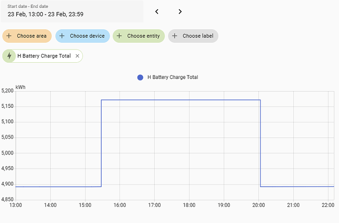

With GivTCP (the addon that integrates my inverters with HA) there is a problem that occurs randomly when one (or more) of the total sensors suddenly jumps to a massively bigger number, only to jump back down when HA or the GivTCP add-on is restarted at some point later on.
(I had two such spikes in this 4 day period)
We could use scenarios 2 or 3 to reload the errant total entity from the GivEnergy Portal, but actually the today entity has been working throughout and we can use that as the source to recover the battery charge total entity:

  1. View the source data we need to migrate from the today entity:
SQLweb add-on. Paste in the following query, substituting your own entity id:
                      WHERE  statistic_id = 'sensor.givtcp_xxxx_battery_charge_today_energy_kwh')  -- source entity id that is being migrated from
AND start_ts >= 1738976400   -- start time stamp
AND start_ts <= 1739314800   -- end time stamp
ORDER BY start_ts
My records look like this:
3633037	NULL	1738980010.7166677	84	NULL	1738976400.0	NULL	NULL	NULL	NULL	NULL	0.0	-10.1
3633345	NULL	1738983610.333431	84	NULL	1738980000.0	NULL	NULL	NULL	NULL	NULL	0.0	-10.1
7.8	-2.3
3636750	NULL	1739023210.269987	84	NULL	1739019600.0	NULL	NULL	NULL	NULL	NULL	10.2	0.1
3637057	NULL	1739026810.2977054	84	NULL	1739023200.0	NULL	NULL	NULL	NULL	NULL	12.6	2.5
3637364	NULL	1739030410.3315246	84	NULL	1739026800.0	NULL	NULL	NULL	NULL	NULL	...
3639205	NULL	1739052010.2764275	84	NULL	1739048400.0	NULL	NULL	NULL	NULL	NULL	14.6	4.5
3639511	NULL	1739055610.265842	84	NULL	1739052000.0	NULL	NULL	NULL	NULL	NULL	17.0	6.9
3639817	NULL	1739059210.2937791	84	NULL	1739055600.0	NULL	NULL	NULL	NULL	NULL	19.4	9.3
[start of next day]
3640124	NULL	1739062810.3110845	84	NULL	1739059200.0	NULL	NULL	NULL	NULL	NULL	0.0	-10.1
3640431	NULL	1739066410.8390033	84	NULL	1739062800.0	NULL	NULL	NULL	NULL	NULL	0.0	-10.1
3640738	NULL	1739070010.2807505	84	NULL	1739066400.0	NULL	NULL	NULL	NULL	NULL	0.0	-10.1
3641045	NULL	1739073610.2697823	84	NULL	1739070000.0	NULL	NULL	NULL	NULL	NULL
0.0	-10.1
From the source entity data in LTS, look at the first record and make a note of the source entity metadata_id (84), state (0.0) and sum (-10.1).
Can see that state increases from zero throughout the day, then resets back to zero at the start of the next day. sum follows a similar pattern of increasing through the day with state and then setting back to the start of day value, but for some reason (a glitch/corruption somewhere in the LTS history) my sum is offset by -10.1kWh.
Note that the difference between the state (0.0) and sum (-10.1) on the first record, -10.1, is the same as the difference on all the other records. The sum is always 10.1 less than the state.
Make a note of this difference figure. Take care of the signs of the state and sum when working out the difference figure, e.g. on my second inverter the state on the first record is 0.6 and the sum is -4.6, so the difference is 5.2.
(Interestingly the sum value resets at the start of each day to a negative number on both the battery charge and battery discharge today entities on both of my inverters. Will need to find out why and fix it - I use the total entities not the today entities in the Energy dashboard so this isn’t visible, but now I know its there my OCD will fester !)
  1. View the LTS for the destination total entity we are migrating to:
                      WHERE  statistic_id = 'sensor.givtcp_xxxx_battery_charge_total_energy_kwh')  -- destination entity id that is being migrated to
AND start_ts >= 1738976400 - 3600) -- start time stamp, the minus 3600 is so we can see the record immediately an hour before the migration time period
ORDER BY start_ts
3632429	NULL	1738972810.3138041	95	NULL	1738969200.0	NULL	NULL	NULL	NULL	NULL	3076.9	3832.8
3633045	NULL	1738980010.7166677	95	NULL	1738976400.0	NULL	NULL	NULL	NULL	NULL	3076.9	3832.8
3633353	NULL	1738983610.333431	95	NULL	1738980000.0	NULL	NULL	NULL	NULL	NULL	5252.0	3832.8
3633661	NULL	1738987210.3023984	95	NULL	1738983600.0	NULL	NULL	NULL	NULL	NULL	5252.0	3832.8
3633969	NULL	1738990810.2936854	95	NULL	1738987200.0	NULL	NULL	NULL	NULL	NULL	5252.0	3835.2
3634277	NULL	1738994410.3125093	95	NULL	1738990800.0	NULL	NULL	NULL	NULL	NULL	5252.0	3837.6
3634585	NULL	1738998010.3042452	95	NULL	1738994400.0	NULL	NULL	NULL	NULL	NULL	5252.0	3840.0
3634892	NULL	1739001610.3087769	95	NULL	1738998000.0	NULL	NULL	NULL	NULL	NULL	5252.0	3840.0
Again for the entity we are migrating to, note the destination metadata_id (95), the state (3076.9) and sum (3832.8) from the first record (which is an hour before the time range we are restoring).
Can see that the state jumps up on the second record and remains constant thereafter. sum updates on the first few records but then stalls at 3840.0.
After correcting the total entity statistics history from the today entity history, it likely that will be a subsequent spike showing in the Energy dashboard. This is due to the sum value not incrementing correctly across the transition from the replaced history to the existing history records.
This is very similar to step 12 of scenario 2, so for brevity, a summary of the correction steps follows:
Looking at the data through the transition by repeating the SQL query from step 3 but expand the ‘start_ts where clauses’ to include a few more records either side, i.e.:

In the records before we updated the history and in the records we updated (up to and including start_ts 1739311200.0) there is a consistent offset difference between state and sum of 755.9. As there has been a problem with the entity state and history wasn’t captured properly for a period of time, the consistency is broken for all records after our history update where the offset is now 3849.2-3153.6=695.6.
This jump in value causes a spike in the Energy dashboard immediately after the history load (23:00 on 11/2/25).
The fix we need to apply (borrowing from the techniques in scenarios 5 and 7) is to adjust sum to bring it into line with state by adding 755.9 - 695.6 = 60.3 to the first record after the history insertion and every record thereafter (because they will all be wrong by this delta amount):

Scenario 7: Dealing with spikes and glitches in HA statistics using SQL
Step 12 of scenario 2 and step 8 of scenario 5 have both already covered part of this, but for a variety of reasons you can end up with glitches or spikes in HA data.
These can manifest themselves either in big jumps in entity values as seen in entity values / entity history
e.g.

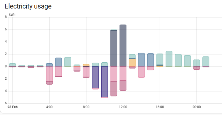

or in the Energy dashboard:
You can fix some of these with Developer tools / Statistics, but:
a) its laborious to only be able to change one entity statistics value at a time
b) you only have the option to change ‘delta value’ for each 5 minute/hourly statistics value, you can’t change the underlying state or sum values, and
c) only the sum value is changed, so the Energy dashboard is OK, but the state value in unchanged so any History graphs are stil messed up
Suggest that it can be better to directly manipulate the statistics entity values and state history in the database using SQL fixes.
For this scenario great care should be taken to ensure you know what you are updating, take a backup beforehand, and if possible practice on a test HA server first.
It is recommended that you DO NOT directly manipulate the HA database whilst HA is running. Although in theory it should work, in practice I have corrupted the HA database twice by doing this so I recommend you shutdown HA, take a copy of the HA database to your local machine, manipulate the local SQLite database, then replace the HA database - ensuring that you keep a copy of the original HA database as well in case you need to recover back to it.
  1. Determine the date/time range to look at
Similar to previous scenarios, determine a window of UNIX datetimes when the glitch occurred - choose times a bit before and a bit after the actual issue so you can see how to blend the corrected data in properly.
Developer tools/template
{% set ds="23.02.2025 13:00" %}
{{ strptime(ds,'%d.%m.%Y %H:%M')|as_timestamp()|int }}
{% set de="23.02.2025 21:00" %}
{{ strptime(de,'%d.%m.%Y %H:%M')|as_timestamp()|int }}
Gives the Unix timestamps for the start and end as 1740315600 and 1740344400 respectively.
WHERE statistics_meta.statistic_id = 'sensor.givtcp_INVID_battery_charge_energy_total_kwh'  -- entity id
AND start_ts >= 1740315600  -- start time stamp
AND start_ts <= 1740344400  -- end time stamp
ORDER BY start_ts
Gives a set of records looking like this:
3851513	NULL	1740319210.507068	176	NULL	1740315600.0	NULL	NULL	NULL	NULL	NULL	4891.8	3912.399	176	sensor.givtcp_INVID_battery_charge_energy_total_kw ...	recorder	kWh	0	1	NULL
3851815	NULL	1740322810.5275633	176	NULL	1740319200.0	NULL	NULL	NULL	NULL	NULL	4891.8	3912.399	176	sensor.givtcp_INVID_battery_charge_energy_total_kw ...	recorder	kWh	0	1	NULL
3852117	NULL	1740326410.5294979	176	NULL	1740322800.0	NULL	NULL	NULL	NULL	NULL	5171.8	4192.4	176	sensor.givtcp_INVID_battery_charge_energy_total_kw ...	recorder	kWh	0	1	NULL
3852421	NULL	1740330010.5471663	176	NULL	1740326400.0	NULL	NULL	NULL	NULL	NULL	5171.8	4192.4	176	sensor.givtcp_INVID_battery_charge_energy_total_kw ...	recorder	kWh	0	1	NULL
3852725	NULL	1740333610.5423589	176	NULL	1740330000.0	NULL	NULL	NULL	NULL	NULL	5171.8	4192.4	176	sensor.givtcp_INVID_battery_charge_energy_total_kw ...	recorder	kWh	0	1	NULL
3853029	NULL	1740337210.582989	176	NULL	1740333600.0	NULL	NULL	NULL	NULL	NULL	5171.8	4192.4	176	sensor.givtcp_INVID_battery_charge_energy_total_kw ...	recorder	kWh	0	1	NULL
3853333	NULL	1740340810.5545213	176	NULL	1740337200.0	NULL	NULL	NULL	NULL	NULL	5171.8	4192.4	176	sensor.givtcp_INVID_battery_charge_energy_total_kw ...	recorder	kWh	0	1	NULL
3853637	NULL	1740344410.5329993	176	NULL	1740340800.0	NULL	NULL	NULL	NULL	NULL	4892.3	3912.899	176	sensor.givtcp_INVID_battery_charge_energy_total_kw ...	recorder	kWh	0	1	NULL
3853941	NULL	1740348010.5478377	176	NULL	1740344400.0	NULL	NULL	NULL	NULL	NULL	4892.3	3912.899	176	sensor.givtcp_INVID_battery_charge_energy_total_kw ...	recorder	kWh	0	1	NULL

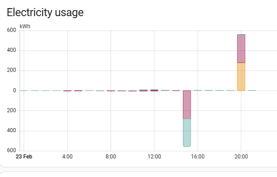

Focussing on the state and sum values, can see that at start_ts of 1740322800.0, state jumps from 4891.8 to 5171.8 (increase of 280) and sum jumps from 3912.399 to 4192.4 (also an increase of 280).
Then state and sum don’t change until at start_ts of 1740340800.0, state jumps back from 5171.8 to 4892.3 (drop of 279.5) and sum jumps back from 4192.4 to 3912.899 (also a drop of 279.5).
NB: If the spike has occurred very recently (i.e. last 10 days) then the STS should be queried to determine what the start_ts is of the start and end affected STS records - they will not be quite the same as the LTS time range as STS is captured every 5 minutes and LTS every hour:
SELECT * FROM statistics_short_term
LEFT JOIN statistics_meta ON statistics_short_term.metadata_id = statistics_meta.id
ORDER BY start_ts
  1. Correcting the entity ‘spikes’
Both sensor history and long term statistics jumped up and down so we can’t follow scenario 1 to recover the statistics.
Could follow scenario 2 or 3 to obtain the correct data from the GivEnergy Portal, but its only a few hours of one day, and over the time period the underlying sensor only actually changed by 0.5kWh (seen as the difference between the jump up of 280 and the jump down of 279.5) so there’s not a lot of detail to extract.
Instead, far simpler is to just correct the statistics data directly. This won’t change the entity history, but its getting the Energy dashboard data right for long term viewing that I care more about, and the entity history will be purged after a few days anyway so limited value in correcting it.
The fix we need to apply is to adjust state and sum for the time period of the spike by simply subtracting 280 from each. Make sure that the correct start_ts time range is used for STS and LTS as they will be slightly different:
SET state = state - 280, sum = sum -280 -- add/subtract adjustment factor to correct for the spike
WHERE metadata_id = 176      -- metadata_id is of the entity to be corrected
AND start_ts >= 1740324300.0 -- start_ts is the time of the first record affected
AND start_ts <= 1740340500.0 -- start_ts of the last record affected
and statistics:
UPDATE statistics
AND start_ts >= 1740322800.0 -- start_ts is the time of the first record affected
AND start_ts <= 1740337200.0 -- start_ts of the last record affected
This technique of directly manipulating sum (and state) can be used to solve many LTS issues that impact history graphs (state) and the Energy dashboard (sum) in Home Assistant.
Just be careful to limit the UPDATE SQL to specific records using metadata_id, start_ts >= and start_ts <= as appropriate.
Also recommended to test the SQL first (using a SELECT statement) or run it on a test HA instance. I trialled all of these techniques on a test HA server before repeating on my live server.
3b. Correcting just a single record/small group of records
As an alternative to step 3 above, you may just have a single record or small group of records to correct that you can visually see what the required change was and its simple to just adjust the individual state and sum values.

Using the metadata id and start time determined in step 2, enter ‘95’ in the box at the top of the metadata_id column
You’ll see a filtered list of records from the statistics table, but showing entries with metadata id’s of 95, 195, 295, etc
Change the entry in the metadata_id column to ‘=95’ to ensure only records that exactly match the value 90 are selected
In start_ts enter ‘>= 1757977200’ - this gives all records with a start_ts greater than or equal to the start time, but I haven’t worked out an obvious way of adding a second filter restriction (of <= end time)
Click the start_ts column to ensure you are looking at the records in ascending time sequence order
If you want to hide some columns from the view, right mouse click the column name and Hide column, e.g. I hid created_ts/mean/min/max/last_reset/last_reset_ts so I could focus on the start_ts, state and sum columns

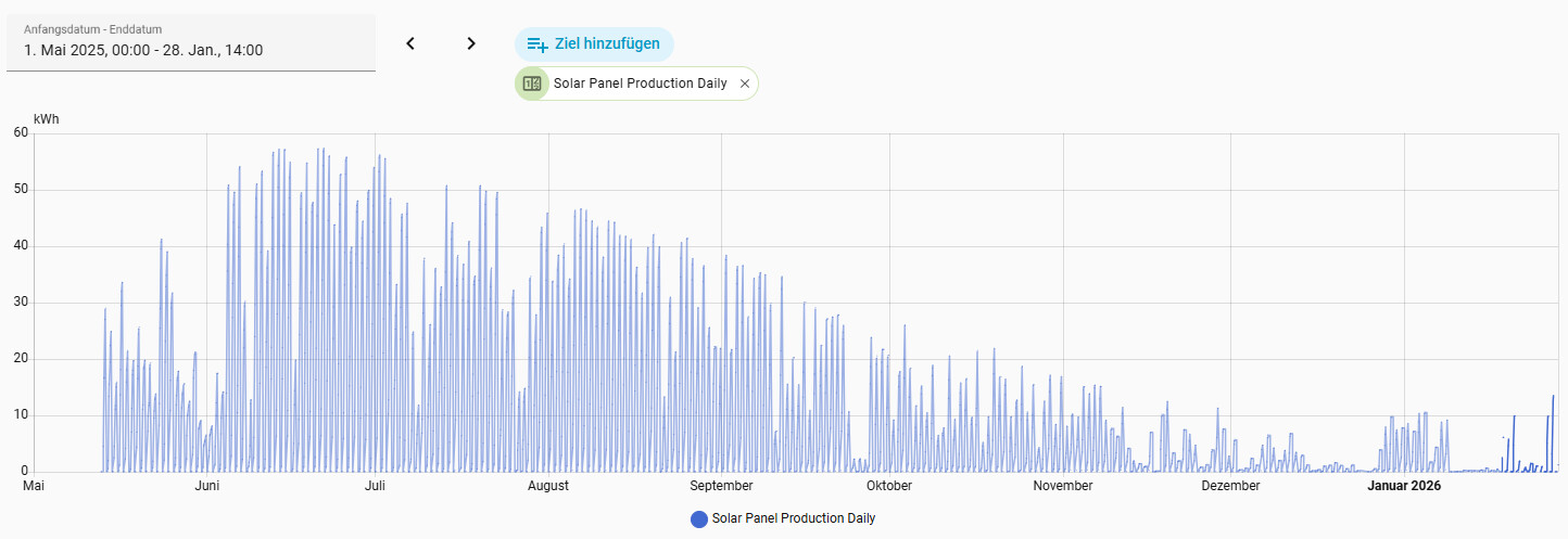

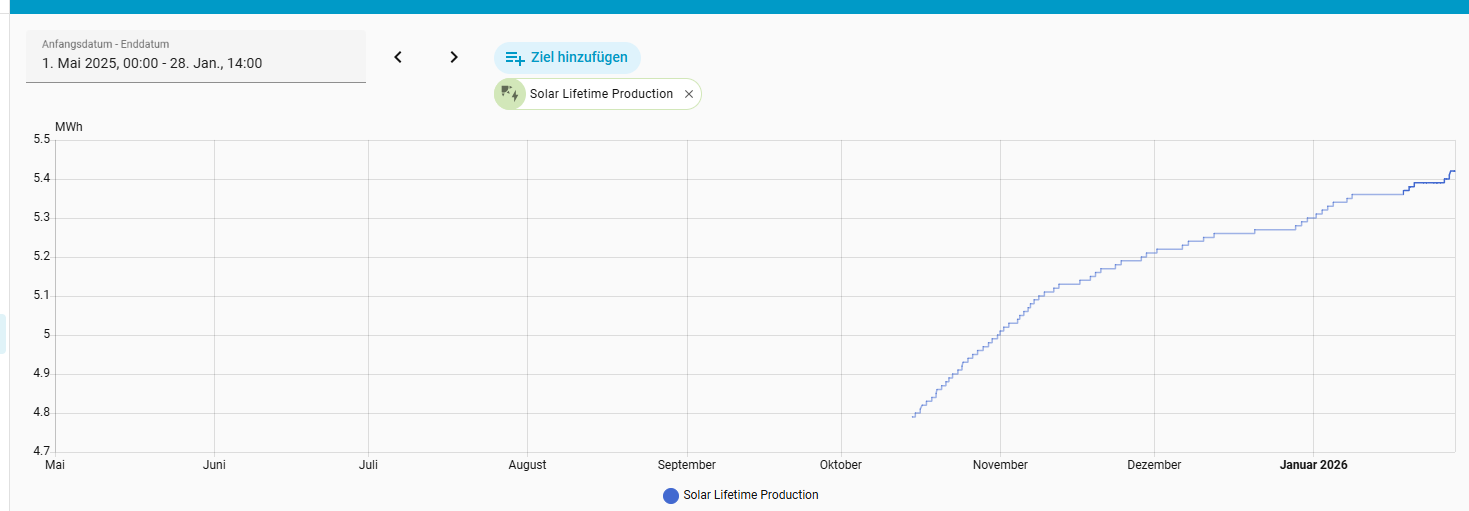

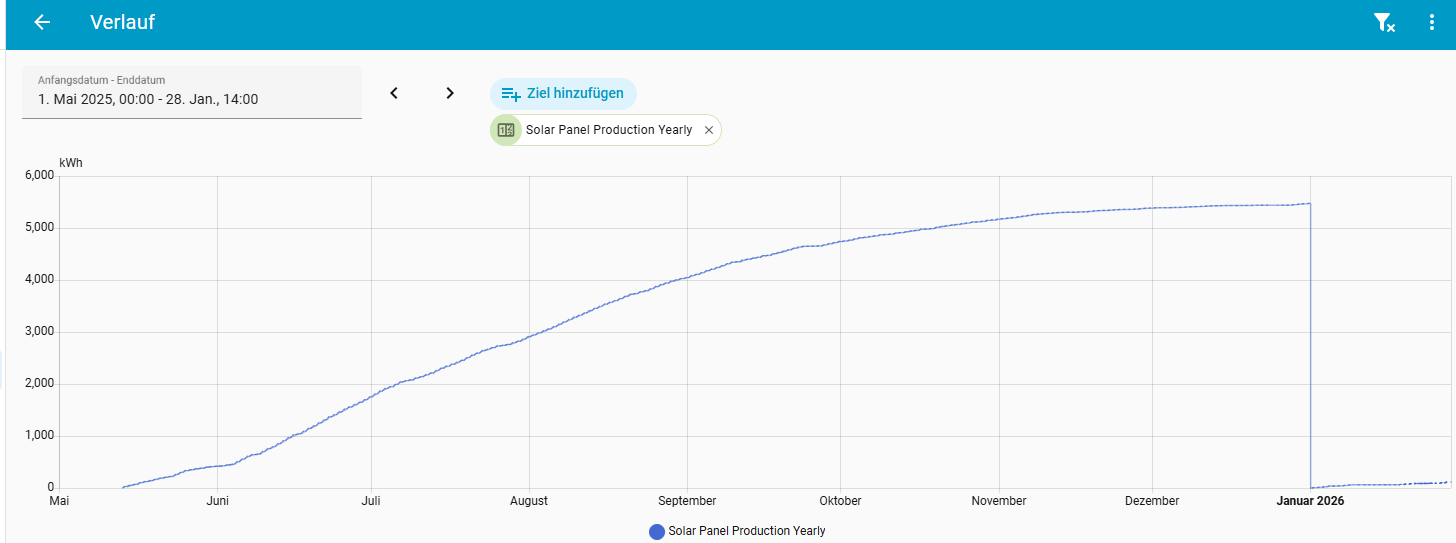

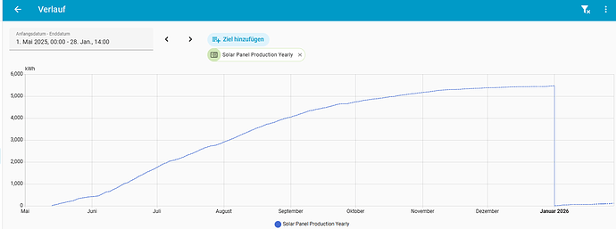

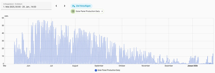

I guess I have the right people in this thread to ask how to do this the “smart” way.
Short recap: I have some solar panels installed and added sensors for daily, weekly, monthly, yearly and lifetime production. All sensors are well defined and work as expected: e.g. the historical data for daily production:
or yearly:
But: lifetime somehow just got the data from October on, don’t ask me why, I have no idea what went wrong.
Now I am looking for a way to fill the gap from begin in May to mid of October without destroying everything else. I checked, the first datapoint is on Oct 14th 21:00, but not with an offset, just starting with 0 MWh.
It might be an approach to copy the yearly sensor data - but how to avoid that the data is just added up to the existing values?
Any help is highly appreciated, I can show more examples if necessary…
