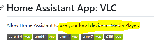

From a bit of searching, there may be a vlc addon (creating a media player) that allows to play locally…not sure as not running HAOS
EDIT : addons/vlc at master · home-assistant/addons
It literally states:
Feature Requests all go here: home-assistant · Discussions · GitHub
Have you tried this integration known as " VLC media player via Telnet". This is very much documented here. I am using this for more than an year now and its working fine with inbuilt Audio of the device HA is running on.
