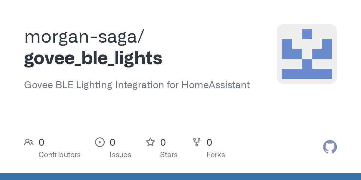

How: hold the GATT connection instead of reconnecting per command. The
firmware kills idle links after ~10 s, so a keep-alive frame every 4 s keeps
it open; the link is released after 10 min without commands. That’s the core
of a fork of the (inactive since 2025) govee_ble_lights integration:
Verified on H601C/H601D (Glide downlights) and H605C; basic power/brightness/
color uses the generic 0x33 frame protocol so most BLE-capable Govee lights
should work. Installable as a HACS custom repository. Maintained as-is for
the hardware I own; issues with model number and debug log are welcome.

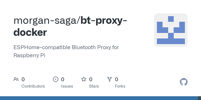

Radio side: my fixtures are out of range of the HA host, so the
connection runs through a Bluetooth proxy on a Linux server that speaks the
ESPHome native API. HA treats it exactly like an ESP32 proxy, but it’s the
server’s BlueZ radio. I hardened a small existing project for this (the
original repo is now archived): write-without-response fallback, forced
active scanning, and a shutdown path that actually exits under systemd:
Caveat for held connections on any proxy: each held link occupies a
connection slot and connects pause scanning on a single radio, so size
max-connections to your fixture count and expect contention if one radio
serves many rooms.
