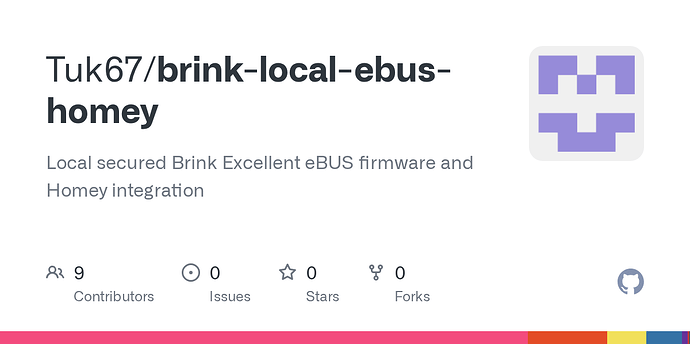

Local Brink Excellent 300/400 control over eBUS using an ESP32-C3
I have published an open-source community preview for fully local monitoring
and control of Brink Excellent 300 and 400 heat-recovery ventilation units. It
uses an ESP32-C3 eBUS Wi-Fi adapter and does not require a Brink Home eModule,
the Brink cloud, or a separate ebusd process.

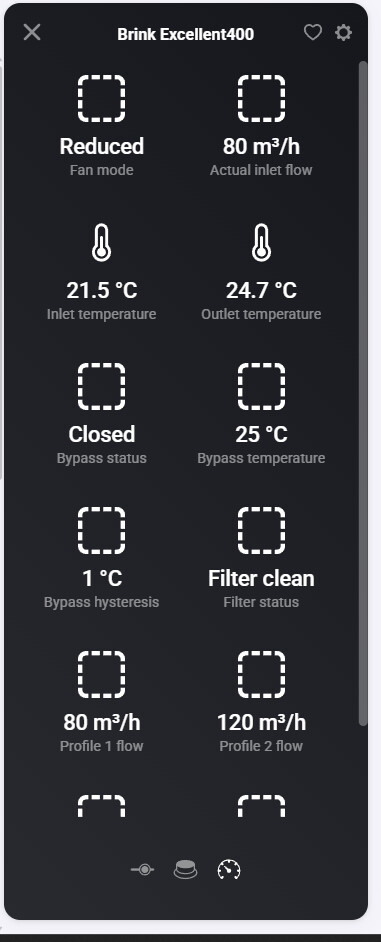

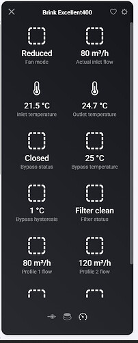

The ESP firmware exposes a cached semantic HTTP API. It reports the fan mode,
bypass state, inside and outside temperatures, measured inlet and exhaust

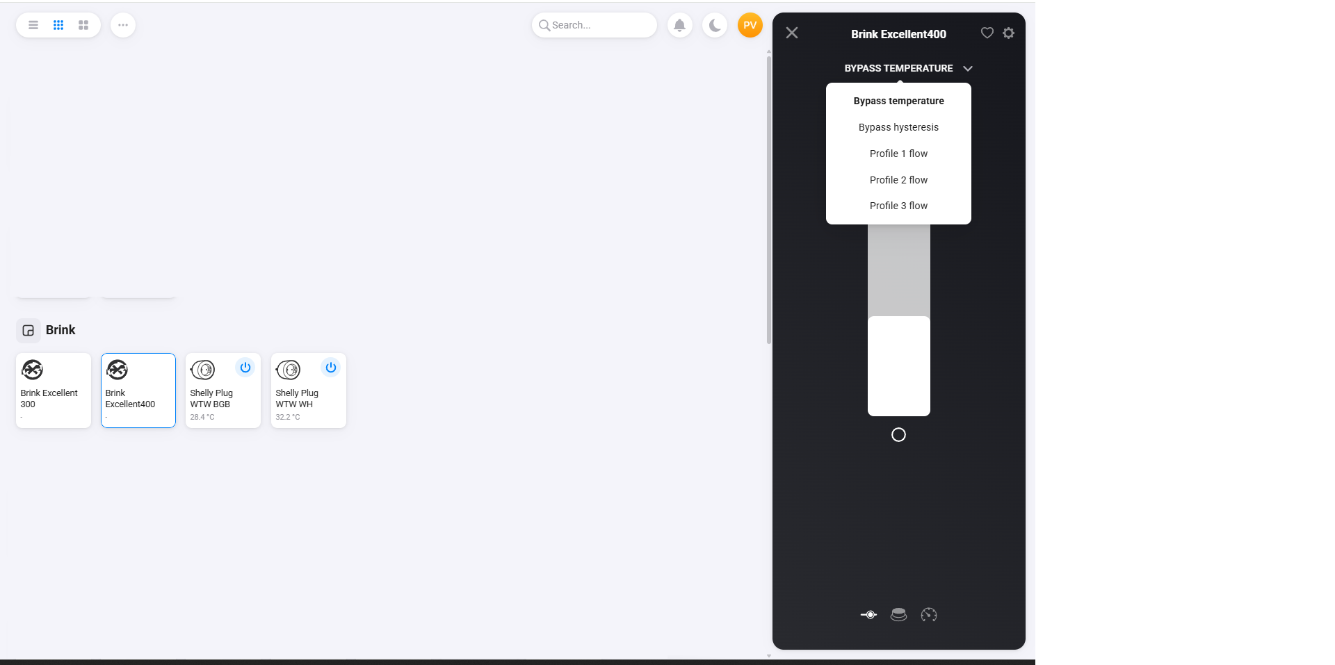

airflow, filter state, configured airflow profiles, bypass temperature, and

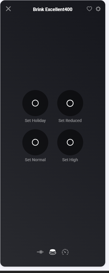

bypass hysteresis. The supported commands cover the four fan modes, airflow
profiles, and bypass settings.

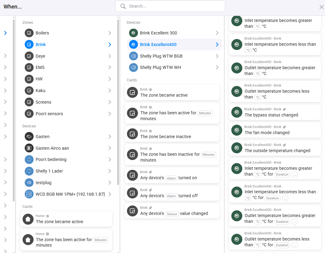

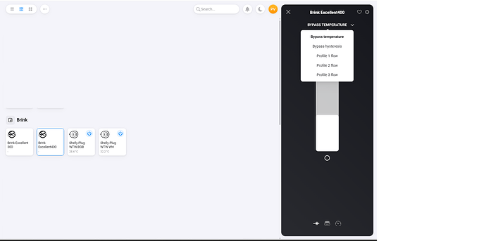

The repository currently also contains a tested Homey Pro app. There is no
ready-made Home Assistant integration yet. Home Assistant support could be
built against the documented REST-style semantic API. MQTT command handling
and automatic Home Assistant discovery are deliberately disabled in this
secured firmware build so there is only one controlled write path.

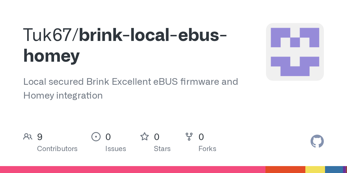

Source, API documentation, build instructions, tests, and known limitations:

Although this was created for Homey, it will be easy to adjust it to HA. Enjoy!
