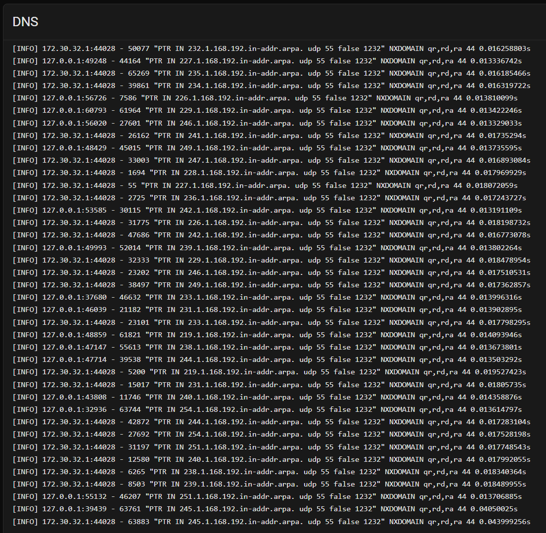

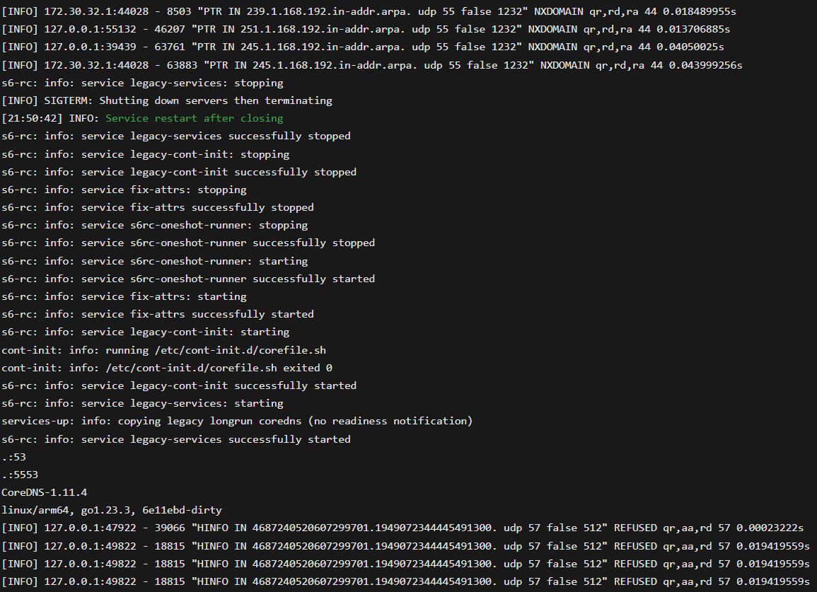

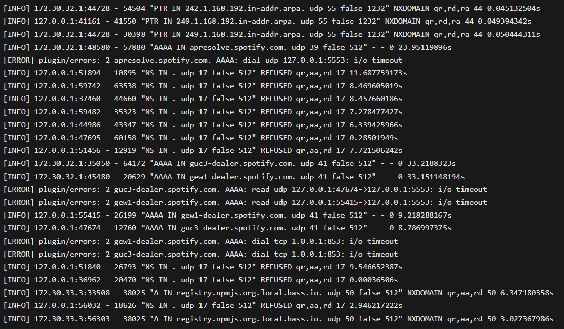

No I have issues, thousands of PTR requests. Does not cause any issues on the surface but is in the DNS logs. All of the IP addresses are leases that are not occupied in my router.
This is with IPv6 set to Automatic in HA Network Settings. Disabling DHCP fixes it for a short while and then it comes back.
With dhcp disabled with default_config_disabler and performing the below commands in terminal
ha dns reset
ha dns restart
I get the below
This is what happens on startups
Ah, yeah I have the same PTR issue. The i/o timeouts on startup never resolved until I created a manual iptables rule, but I think it’s essentially the same issue. The DNS provider is 1) dropping the IPv6 query, causing the i/o timeout (notice the timeouts are all AAAA requests, which HA is prioritizing); and 2) sending the PTR requests out to the upstream DNS provider, which is returning NXDOMAIN (which is accurate).

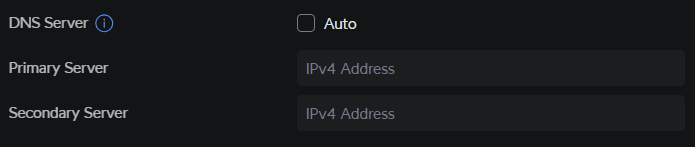

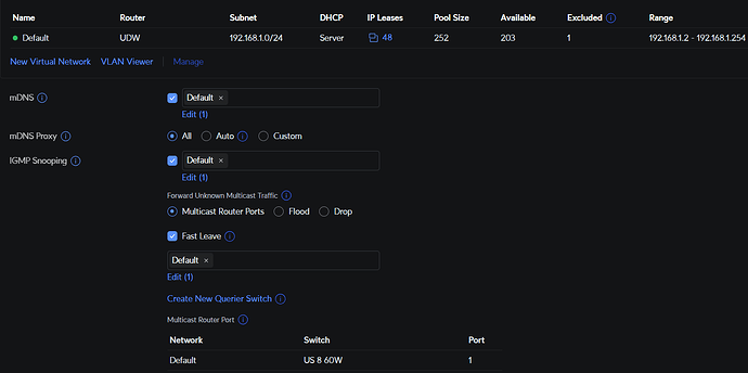

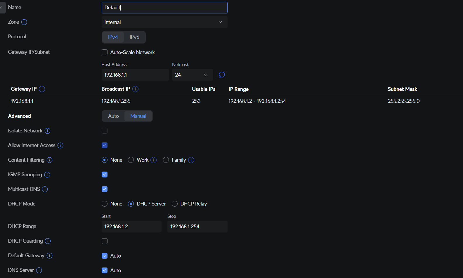

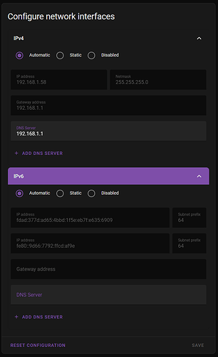

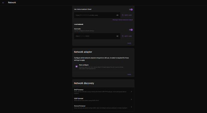

Home Assistant Network Settings
Unifi has the following options

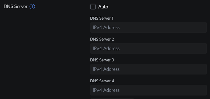

Under Network Options
If unchecking auto given these options.

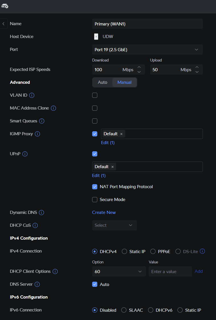

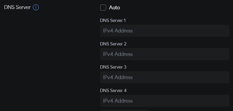

Under Internet Options
if unchecking Auto

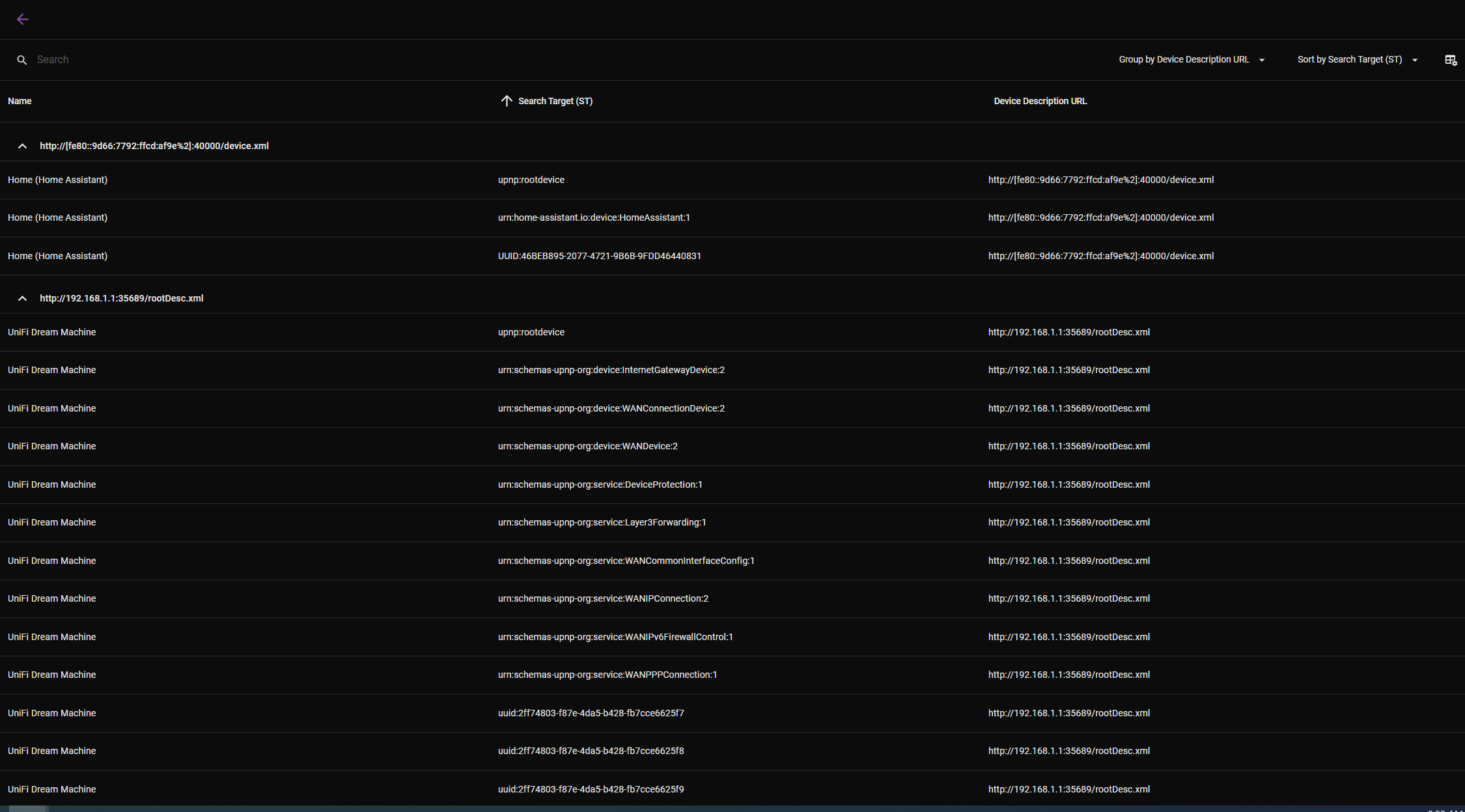

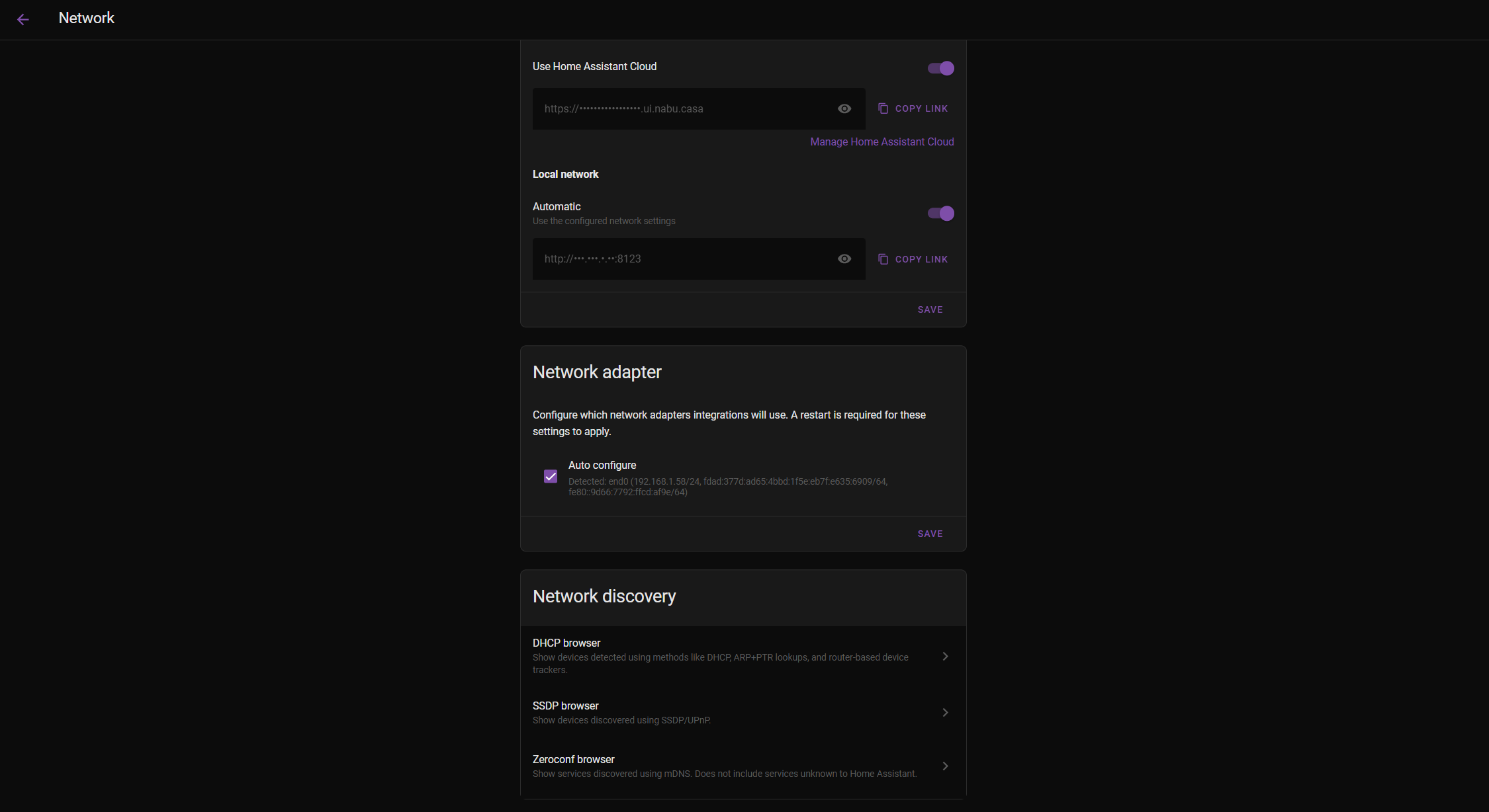

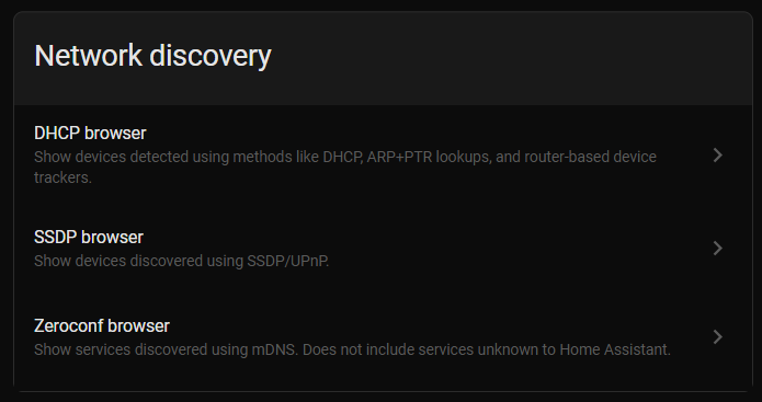

I just found a new box at the bottom of the HA Netwok Setting Page. Network Discovery
Clicking in SSDP I get the following. DHCP is blank as I have DHCP turned off at the moment.

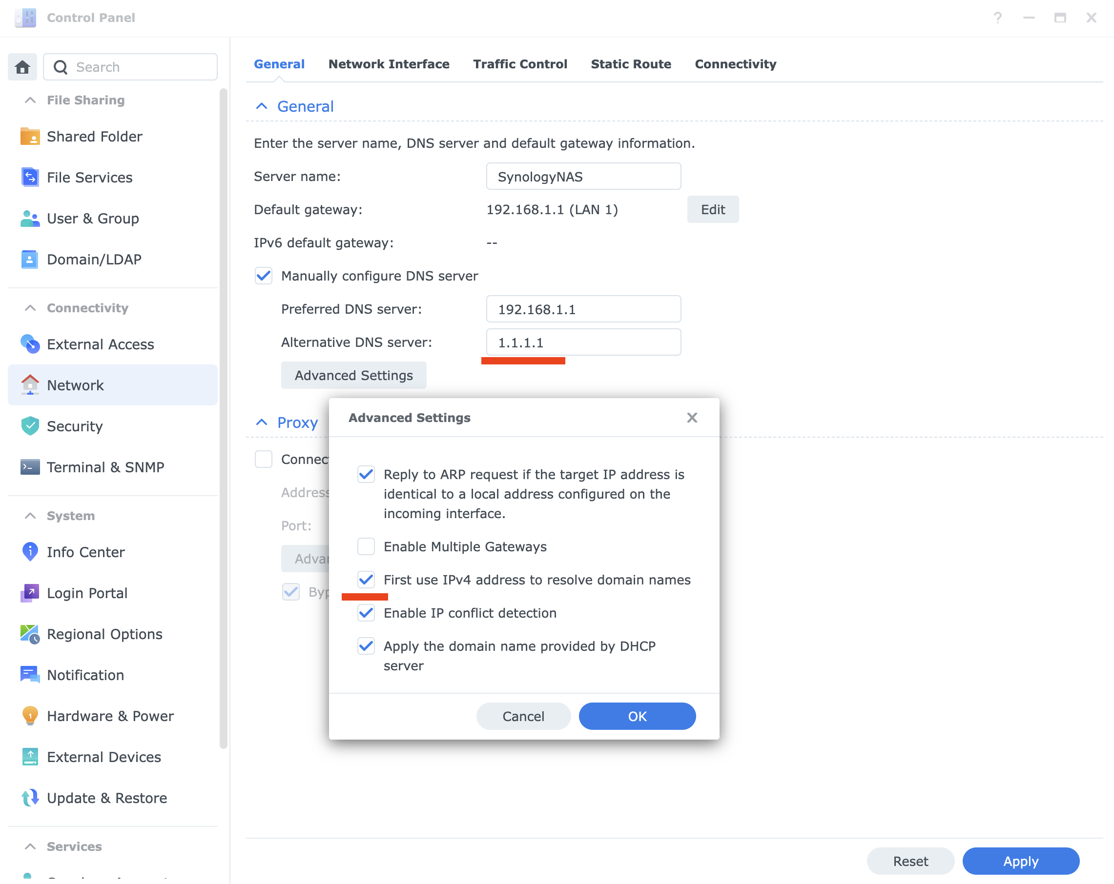

If you are using Synology and host HA in the dock this will help you:
