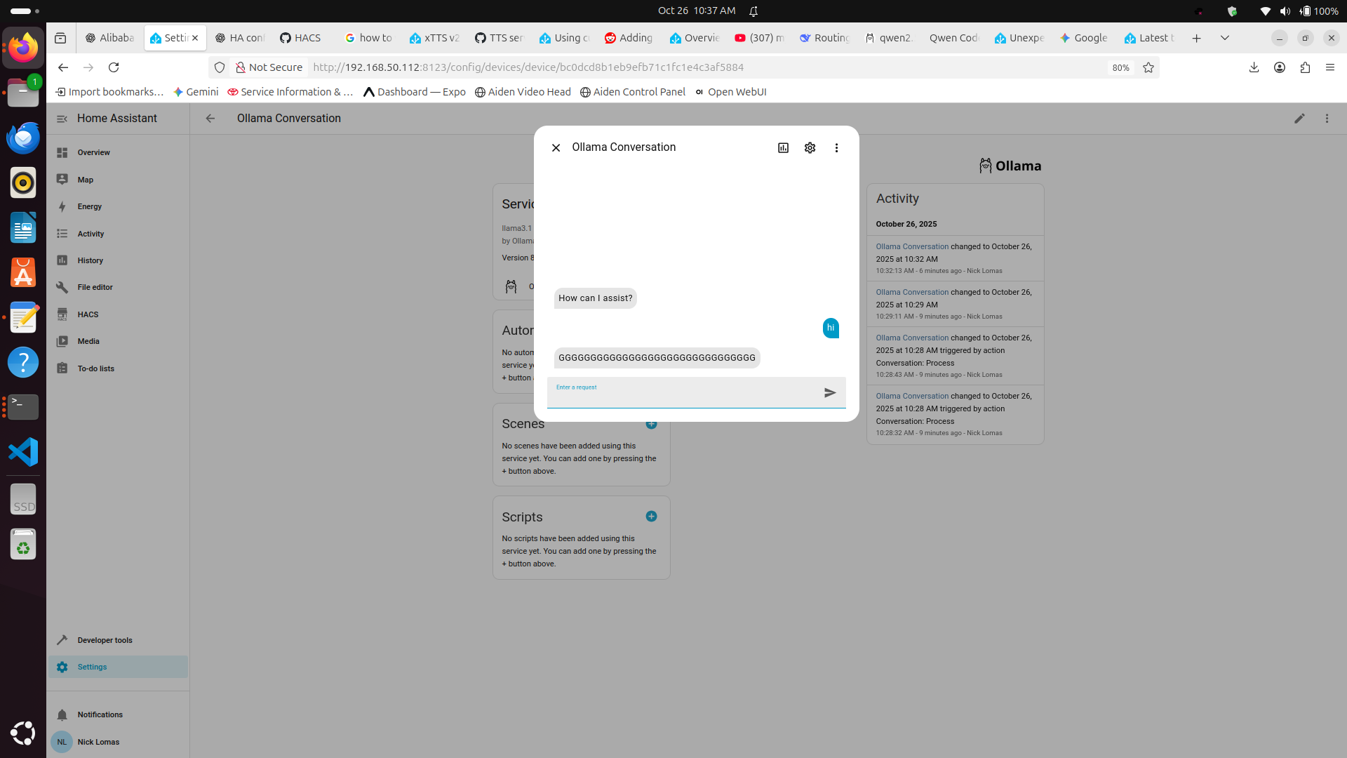

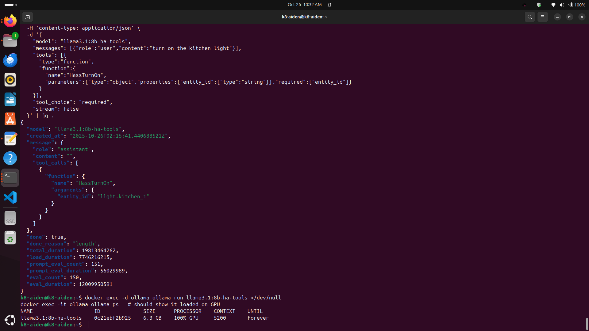

Hi, I have spent days with AI going round and round in circles with no cigar. The inbuilt HA assistant controls things fine, but when I try to use Local LLM runing on my service i get GGGGGGGGGGGGGGG as a response. I can use the LLM when I SSH in to the machine its on (GMKtec K8+) I am using rocm for gpu acceleration, 64gb ram and 16gb dedicated to vram. Everything functions fine in there respective containers the problem appears to be HA sending requests to the K8.

I have seen the same thing, i am using a Nvidia Jetson Orin Nano, from terminal its working fine. I do find that sometimes if I i delete the ollama integration and start over it works. However the model i was using was " thinking out loud" qwen3:4b and so that took it 3 minutes to explain to me how to turn off a light. I will play and try more models and see if i can find one that works well.I will report back if i have progress.
so , i have tried other models, and they all seem to either immediatly fail or do the GGGGGGG thing. So far only qwen3:4b working, but dang its slow for HA
