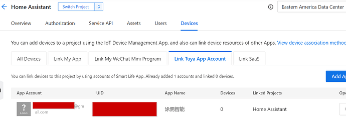

I’m not sure that this matters because it never mattered in my HE Tuya integration but my smart life app link says zero devices. It has always said this:

Yep, this confirms I’m doing everything right. I reconfigured the project (because you cannot delete projects). When linking to the smart life app, I scan, it logs in and links the app but it says zero devices. He breezes right on by that because it should be working.
He has the same screen as me with 16 devices where I have the same screen it says zero. I unlinked it and re-linked it twice. I also moved a device from the smart life app to the tuya app and I received the same problem. Because my tuya and smart life apps had the same credentials I created ANOTHER tuya app, slapped a fan in it, linked it up and it did the same thing. zero devices:
I put in a ticket because the app name also shows in another language unlike the tutorials. I have very old accounts before any of this was available and I’m thinking that something is twisted with the account management on their end. The fact that it has always said zero is very curious (even with my HE integration).
I was informed in another thread that there’s been problems with their iot platform today. I’ll wait for a response from them. Thank you for all the valuable information, I wouldn’t have made it this far without that much.

Sure did. When Tuya contacted me, they told me to switch servers. I know all the tutorials said to be careful of that fact but it was counterintuitive because I am in Atlanta and I was connecting to the Eastern Americas server. They told me to switch to the Western Americas server and as soon as I did, everything started flowing.
Was it just for the project? I was using Western America, and have just tried Eastern America, but neither seem to work.
I went back and double checked my settings. It looks like the project is configured for both (because Tuya’s EXACT verbiage to me was “ADD the western server” they didn’t say replace).
but then on the device page, select the western server (this is what made the data flow)
