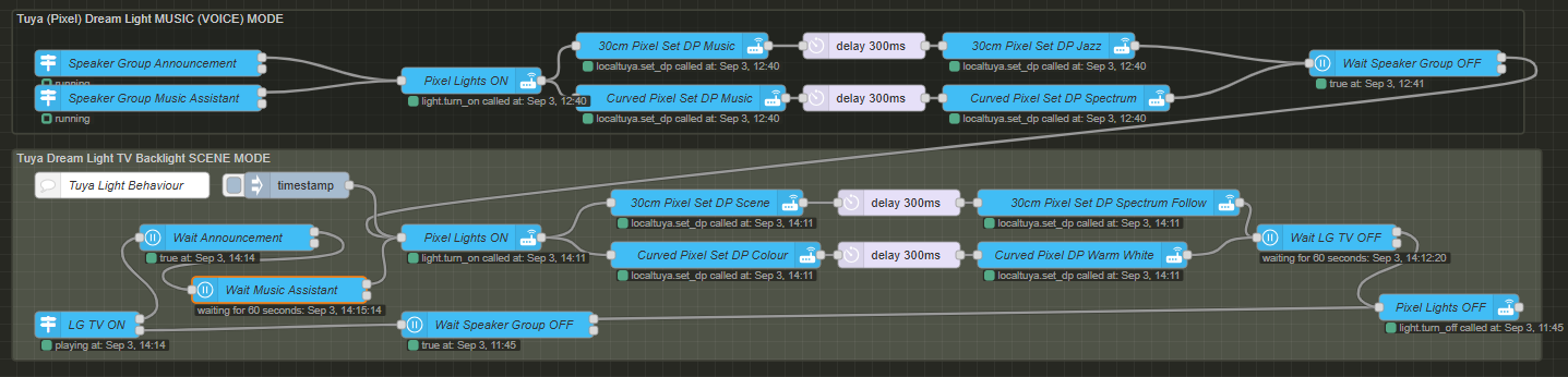

How to send patterns in Home Assistant (LocalTuya)
LocalTuya set_dp takes only: device_id, dp, value.
Use entity_id only for light.turn_on.
Send pattern: the reliable sequence
  1. Turn the light on (brightness here, not in the body):
service: light.turn_on
  entity_id: light.YOUR_ENTITY
  brightness: 180
  1. Select mode (dp: 21) — "music" or "scene":
service: localtuya.set_dp
  device_id: "INSERT_YOUR_TUYA_DEVICE_ID"
  dp: 21
  value: music
  1. Wait ~300 ms (important).
  2. Send the bodydp: 52 (Music) or dp: 51 (Scene):
# Example: Music → Jazz Smooth Rainbow
  dp: 52
  value: AQEAAmRkAAAAZAAAZAA8ZAB4ZAC0ZADwZAEsZAAAAA==
Placement-ready examples
Music → Jazz (backlight voice mode)
data: { entity_id: light.YOUR_ENTITY, brightness: 180 }
data: { device_id: "INSERT_YOUR_TUYA_DEVICE_ID", dp: 21, value: music }
  dp: 52
  value: AQEAAmRkAAAAZAAAZAA8ZAB4ZAC0ZADwZAEsZAAAAA==   # Jazz Smooth Rainbow
Music → Spectrum (direct-view; placeholder fix required)
data: { entity_id: light.YOUR_ENTITY, brightness: 220 }
  dp: 52
  value: AQEDEGRkAAAAZAAAZAA8ZAB4ZAC0ZADwZAEsZAAAAA==
#          └── after header, the 3-byte placeholder must be 00 00 00 → base64 "AAAA"
Scene → Follow (smooth rainbow backlight)
data: { entity_id: light.YOUR_ENTITY, brightness: 140 }
data: { device_id: "INSERT_YOUR_TUYA_DEVICE_ID", dp: 21, value: scene }
  dp: 51
  value: AckIMjIAAABkAChkAFBkAHhkAKBkAMhkAPBkARhkAUBk

Example NodeRED Flow
Gotchas (read this)
  • Always: light.turn_ondp:21~300 ms delaydp:52/51.
  • Brightness: set with light.turn_on (not in dp51/dp52).
That’s it. Copy the YAML blocks, replace light.YOUR_ENTITY and "INSERT_YOUR_TUYA_DEVICE_ID", and you’re off.
