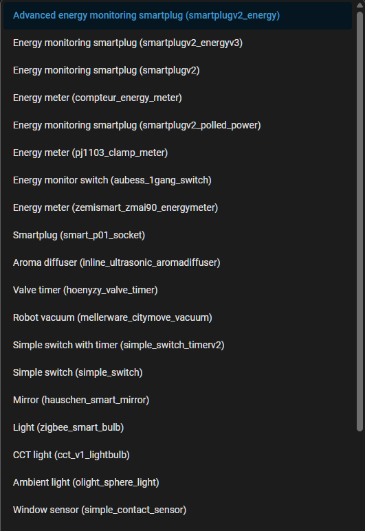

and I'm trying to add some smart plugs how am I supposed to know which type it is?
and how can I try different types without deleting and adding again which takes about four or 5 minutes each time

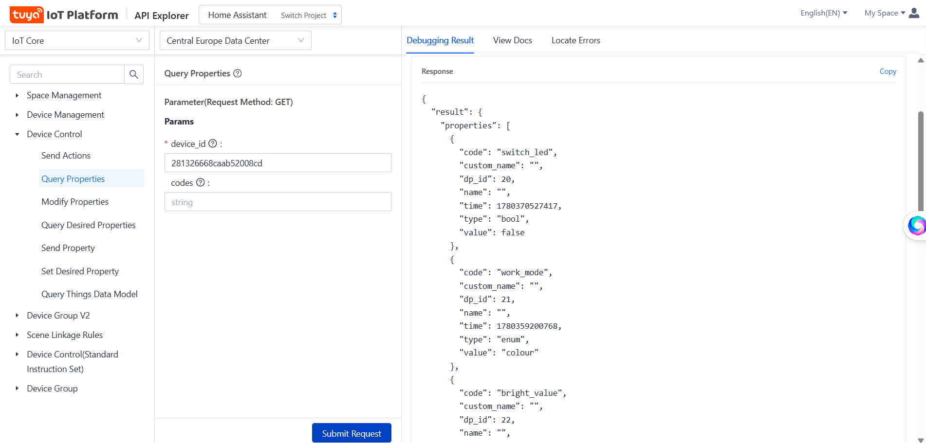

I also want to ask how do I know if these values are correct for example for a light bulb that has colour
do I just assume it has somehow detected the correct values for the correct fields
we've been looking at the options I wouldn't really know

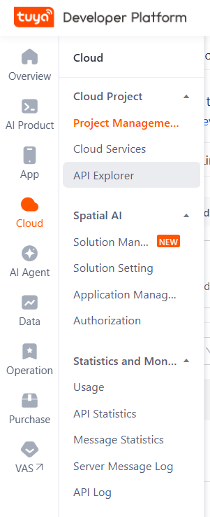

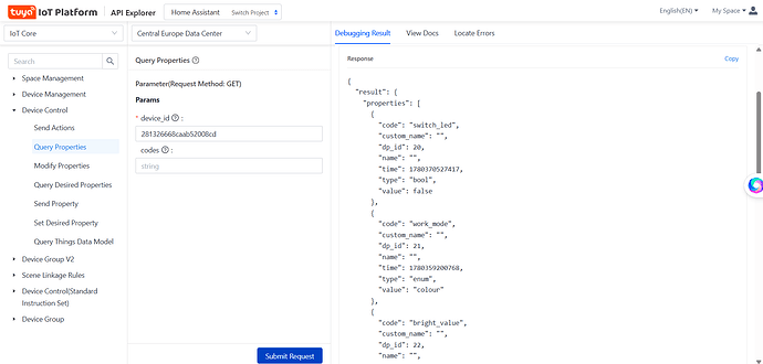

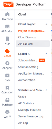

@aussie1497 Tuya Developer Platform >Cloud >API Explorer
This will give you the best idea of what the device capabilities are and what data point (dp_id) it belongs to. >Device Control >Query Properties
