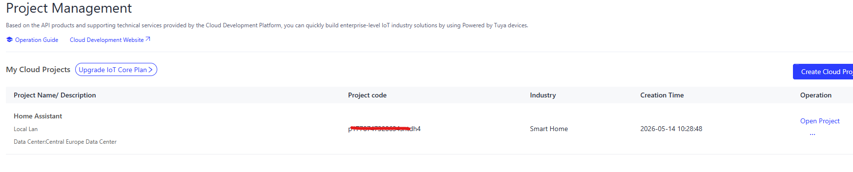

I first created an project:

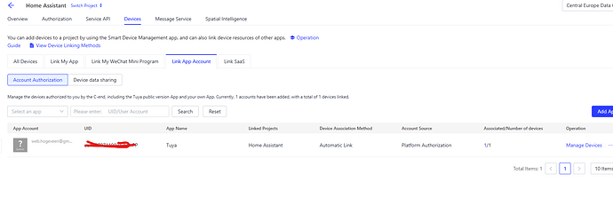

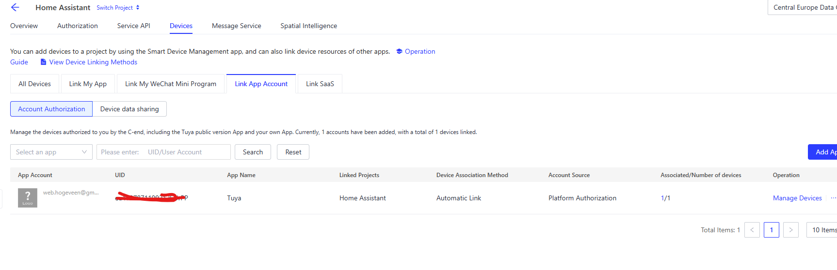

I did also link my app account for the User ID:

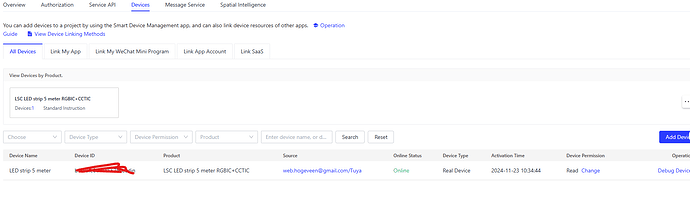

My device is vissible and online in the project:

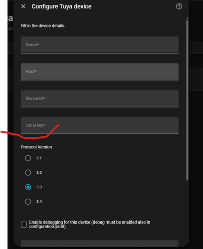

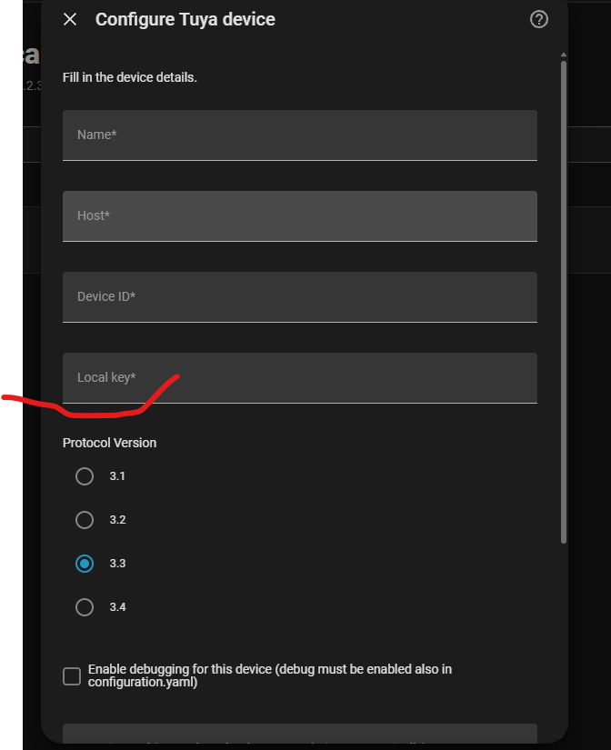

Also not at manual adding a device.
I don't know the Local Key asked?
What am I doing wrong?

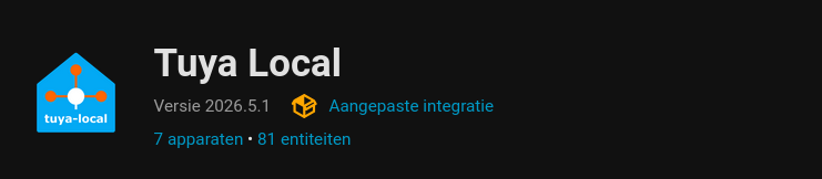

Thanks. I will invest
Better use Tuya Local, it is better maintained
Thats exactly I came out to.
It is now running fine
Thanks for the advice
My device needed 3.5 format. Local Tuya did only go to 3.4
Tuya Local did the trick
