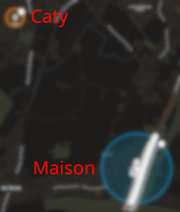

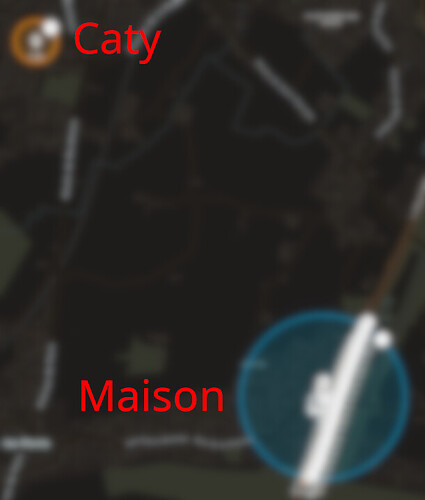

There is the zone Maison = my house and the zone Caty = my mom.
And here my phone is at my house, then go away = absent, then go to caty that is consider as present at my house but its not physically and immediately go away again.

I understand but my phone seem to be detected correctly when i look every detection points on the map.

In my logs that is what happens at 9:35:01 : enter in my mom zone and that trigger my home automation above with no reason...
