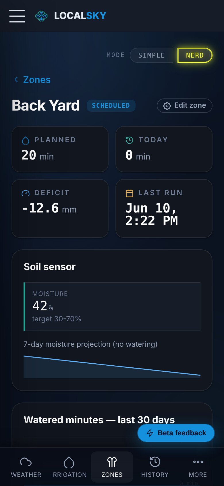

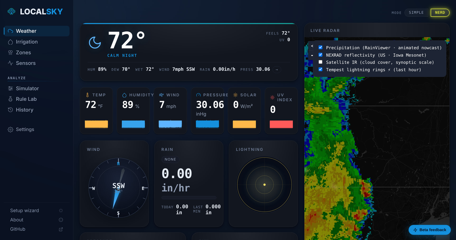

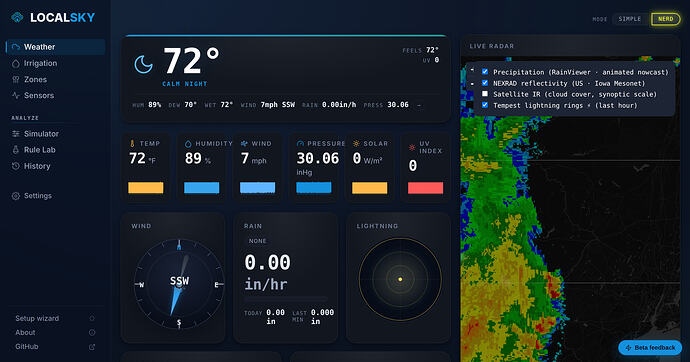

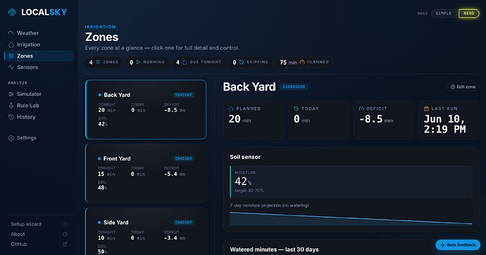

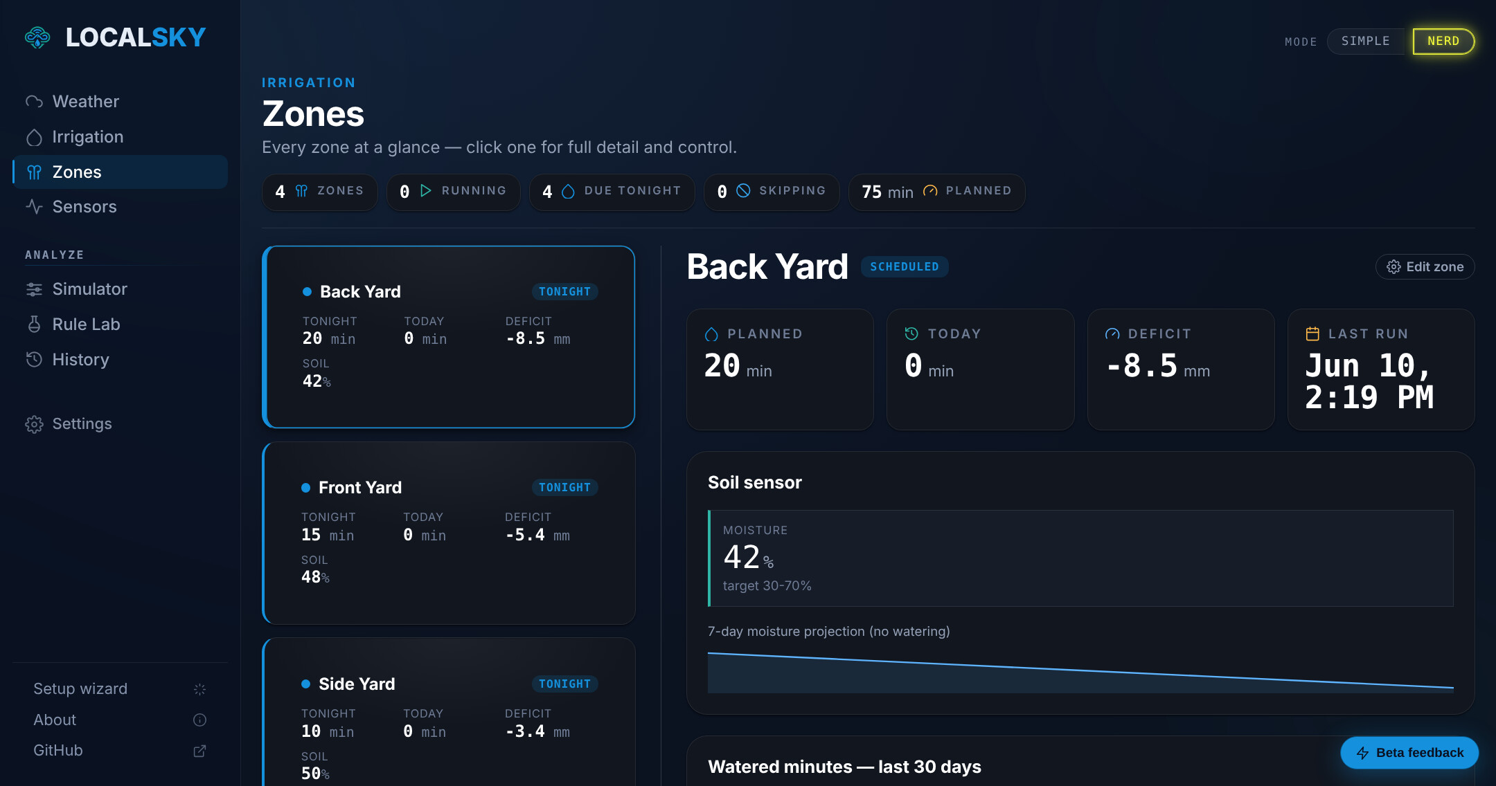

I have been building this for the past few months and just published it: LocalSky is a self-hosted weather and smart-irrigation server that runs as one Docker container on your own hardware, and pairs with Home Assistant through a native integration.
The short version: it pulls live weather from your own station (Tempest over UDP, Ecowitt gateways polled locally, Davis WLL, Ambient, and more), merges in forecast models (Open-Meteo worldwide, NWS in the US, MET Norway, OpenWeather, Pirate Weather), and uses FAO-56 Penman-Monteith evapotranspiration to decide, schedule, and run your irrigation. It talks to controllers directly (OpenSprinkler, Rachio, Rain Bird, Hydrawise, B-hyve, MQTT), so watering keeps working even if HA is down.
What HA gets through the integration:
  • Every weather reading as sensors, with device classes so unit conversion follows your HA settings
  • Per-zone soil moisture, planned runtime, running state, and valves (real valve entities)
  • Today's run/skip verdict with the reason

  • Dashboard only works with Tempest data and ignores local weather sensors.
  • Temperatures are expected in imperial. Local weather sources with celsius don't work.

  • Non-Tempest sources actually drive the dashboard now. The whole source layer got rebuilt, so Ecowitt, Ambient, Davis and the rest are first-class, not Tempest-with-extras.
  • Metric sources read correctly, and you pick your own display units.
