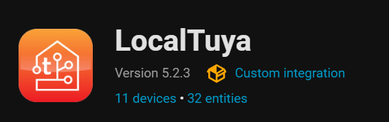

In LocalTuya
1 blanket works
the 2nd, I tried to edit. Still greyed.
I deleted and added again. It could find the key & ip auto filled.
Once I do, ALL LocalTuya devices grey.
Log says Could not find device for device_id x200 times.
What sould I do?

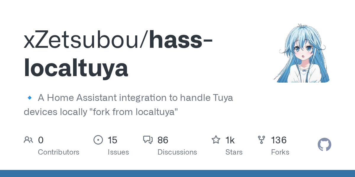

I use the xZetsubou fork of LocalTuya
Works more reliably for me but if you have it working with TuyaLocal stick with it.
Documentation in below link.
