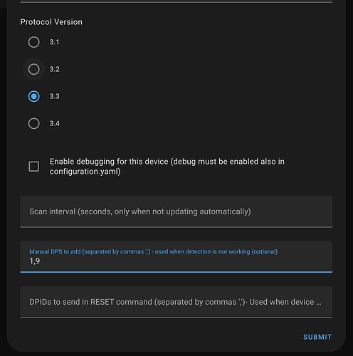

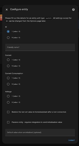

LocalTuya doesn’t find any entities (the DPs) automatically, and even if I specify the dp_id of the entities as reported by the API explorer of localtuya, it doesn’t work, all entities report a value of -1. What might be going on? I couldn’t find any troubleshooting for cases like this.

Both fields report a value of -1, which seems inconsistent with what the API explorer reports:
Any idea of what is going on?
