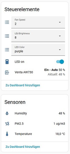

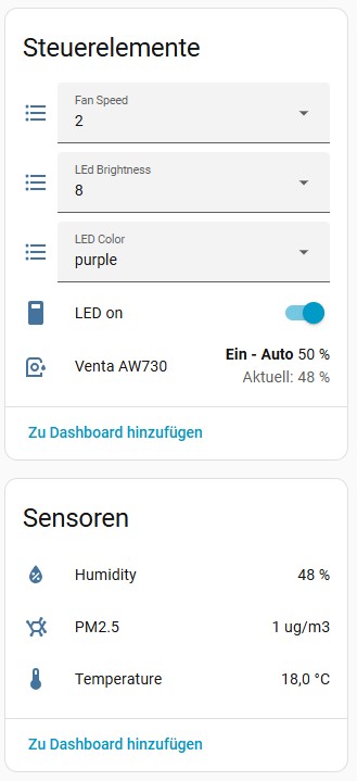

I’d like to share a LocalTuya device template for the Venta AW730 AeroStyle Compact, based on a fully working real‑world setup.
It might also work with other Venta models with Tuya.
This template is intended for use with xZetsubou/hass-localtuya and provides broad device coverage, including humidifier control, sensors, maintenance data, and LED control.
:white_check_mark: Tested setup
  • Home Assistant: 2026.4.1
  • LocalTuya: xZetsubou/hass-localtuya
  • Tuya App: Smart Life
  • Protocol: Tuya LAN 3.4
  • Device: Venta AW730 AeroStyle Compact (Wi‑Fi)
