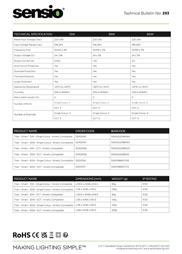

I have one other Tuya based device. It’s actually a Sensio Titan Smart Kinetic CCT driver ([Titan Smart Kinetic CCT Driver (4-pin distribution ports)]), it supports three independent LED channels up to 30W total, each channel controllable for brightness and colour temp. Prior to HA I was controlling the device directly using either the Sensio app or, more latterly, the Smart Life app and again, worked fine.
