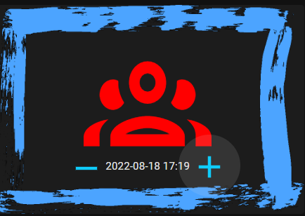

And when I enable it it should have turned green, I need to figure that out. But it gives me the option to set the expected time they leave.
At that time the guest mode is turned off automatically.

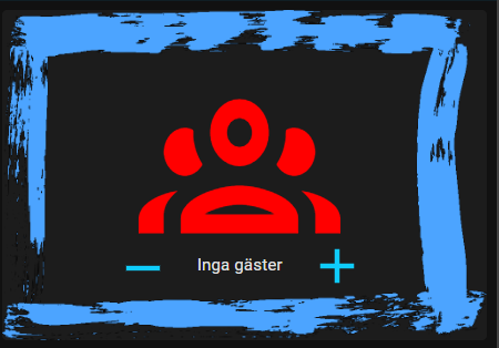

Can I ask how you added this card? I’m looking for something similar (actually for an input_number right now), but I can’t see a similar card?
It’s a picture elements card.
So it’s custom. edit, not custom as custom integration, but you customize it how you want.
This card was created before the button entity existed so I had to use input booleans as buttons and the automation it triggers resets the boolean to off again.
I could have used scripts instead but I didn’t think of that.
type: picture-elements
tap_action:
  action: none
hold_action:
  action: none
image: local/frame3.png
