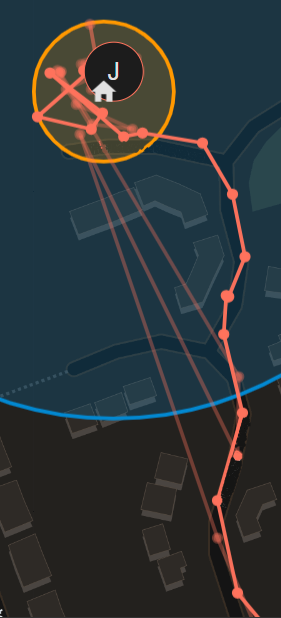

When using the android app to track my phones location, the location HA gets sometimes leaps between where I actually am and somewhere in my home zone:
This pic shows me both going out and coming home. The paler line shows the issue… I wasn’t teleporting home and back as it shows.

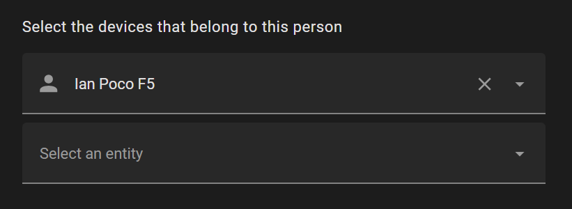

Double check in Settings > People > (Click your person entity) to see if there are any other devices attached to your profile:
There’s just the one android phone.
The pic of a map above shows the persons location, but the phones location does exactly the same. So it looks like it’s the phones location jumping around that isn’t right. It doesn’t do it all the time either.
