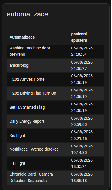

type: custom:flex-table-card
title: automatizace
max_rows: 10   #Without that, it shows all automations.
sort_unmodified: true
entities:
  include: automation.*
sort_by: last_triggered-
columns:
  - name: Automatizace
    data: name
  - name: poslední spuštění
    data: last_triggered
    modify: |-
      if (x) {
        if(x.length == 0){
        else {
            var date = new Date(x);
            (String(date.getDate()).padStart(2,'0')) +
            (String(date.getMonth()+ 1).padStart(2,'0')) +
            date.getFullYear() +
            String(date.getHours()).padStart(2,'0') +
            String(date.getMinutes()).padStart(2,'0') +
            String(date.getSeconds()).padStart(2,'0')
      } else {

I’ve been using this card for a while and it works, so I had no reason to change anything. Since the card is one of the examples shown here, it would be better to direct the question there.
