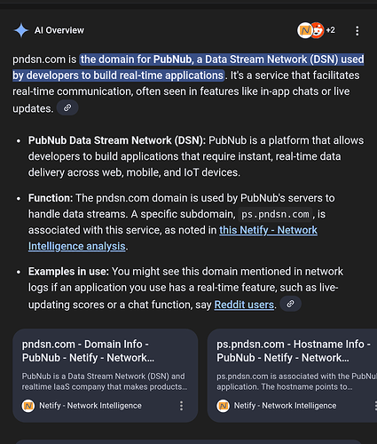

Docker container sometimes crashes so i was trying to look into the HA logs (which were 1.8 gigs for 7 days) and found the following. Unsure how to track down what is trying to do this or why it’s trying 40 times per second 24/7. Google says it’s pubnub. Unsure what that is. Running on Synology Nas in docker if that matters. Any help would be greatly appreciated.
