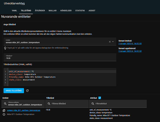

  2. Show the definition of the sensor
Hello AndersNilsson19,
The sensor has to be a number, it has to have a state_class defined and it has to have a unit of measurement defined to be added to LTS (stored longer than 10 days)
So i must insert “unit_of_measurement: °C” in config yaml ? Is that the problem why it not on LTS?
