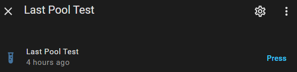

I have a helper (input_button.last_pool_test) that displays the last time I had my pool water tested.
I display it in an entities card:
type: entities
entities:
  - entity: input_button.last_pool_test
    secondary_info: none
    type: simple-entity
When I have a test done, I simply click on the entry and hit ‘Press’ - that all works fine:
Now I’d like to keep track of the test dates, but they don’t make it into the long-term stats due to the nature of the helper entity itself.
Any quick hints on how to do this, maybe without creating a datetime entity for it?
