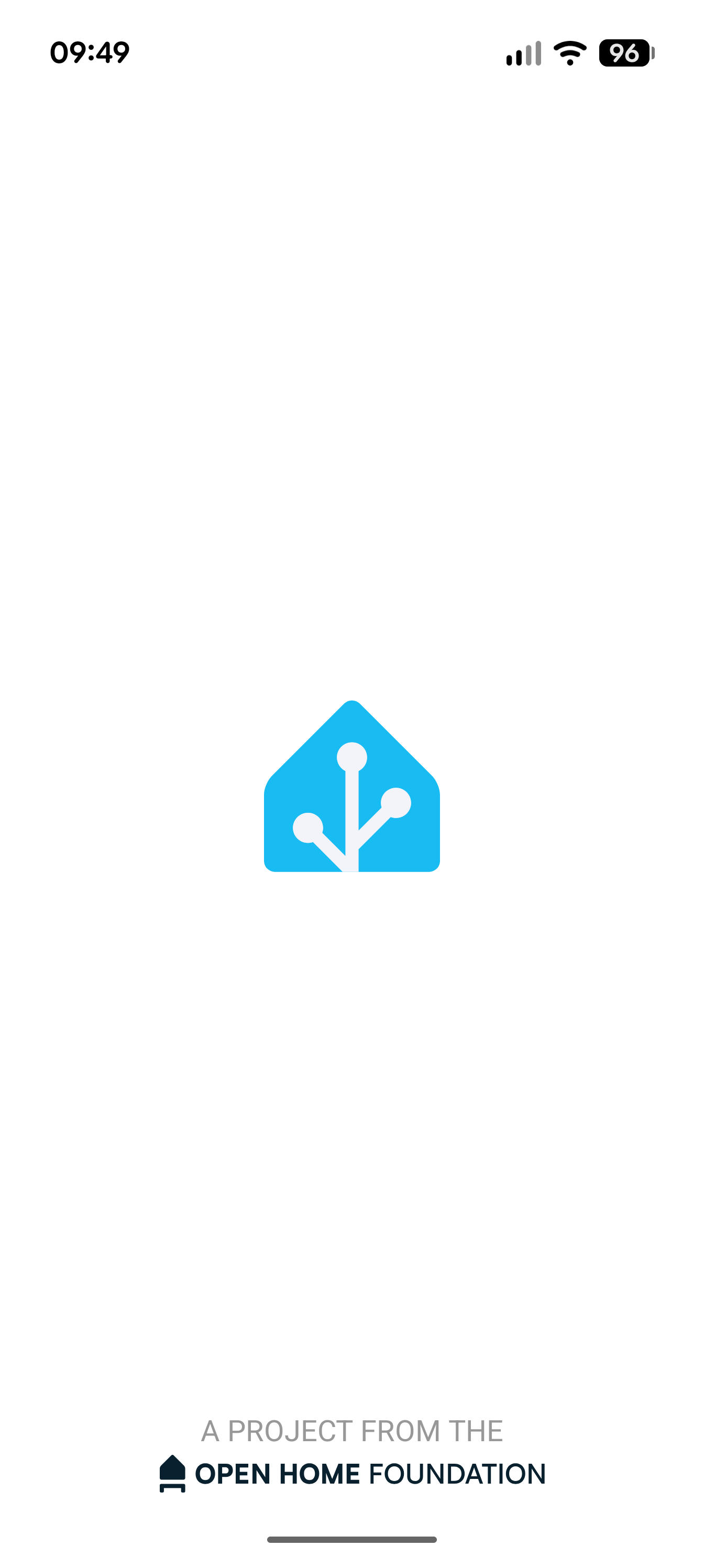

I recently changed phone (Pixel 11), reinstalled the companion app and everything works as expected. Except that I’m now experiencing longs waits (5-10s displaying the screenshot below) every time I launch the app after roaming between APs on my LAN:
This was not happening with my old Pixel phone.

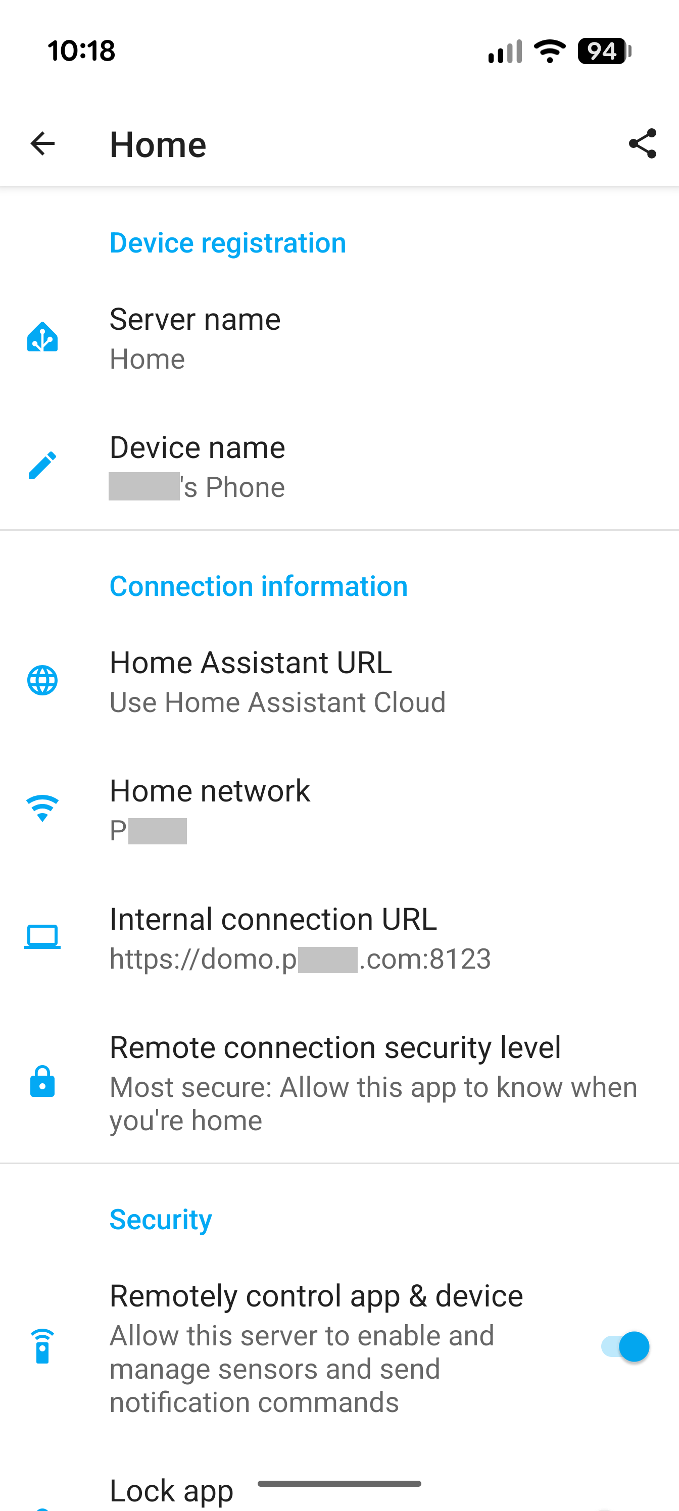

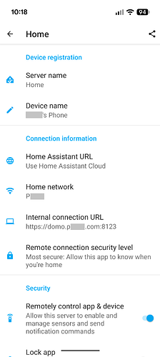

App config is as follow:
If I leave the internal URL blank (and I always connect through Nabu Casa) I see no noticeable delays when starting the app.
I have a valid (CA signed) *.mydomain.com certificate installed, my gateway is a Ubiquiti UDM-SE (with a split DNS), and the APs are Ubiquiti U6-Pro.
