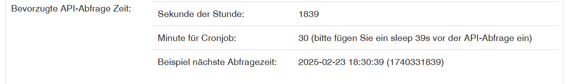

I already know… I can’t get any further with it.
I’m only allowed to pick it up at certain intervals.
Today: Every hour + 30min + 39sec.
So: 19:30:39
20:30:39
But I get the times back with every query (epochTimeUtc).
I have not yet found a solution for this.
