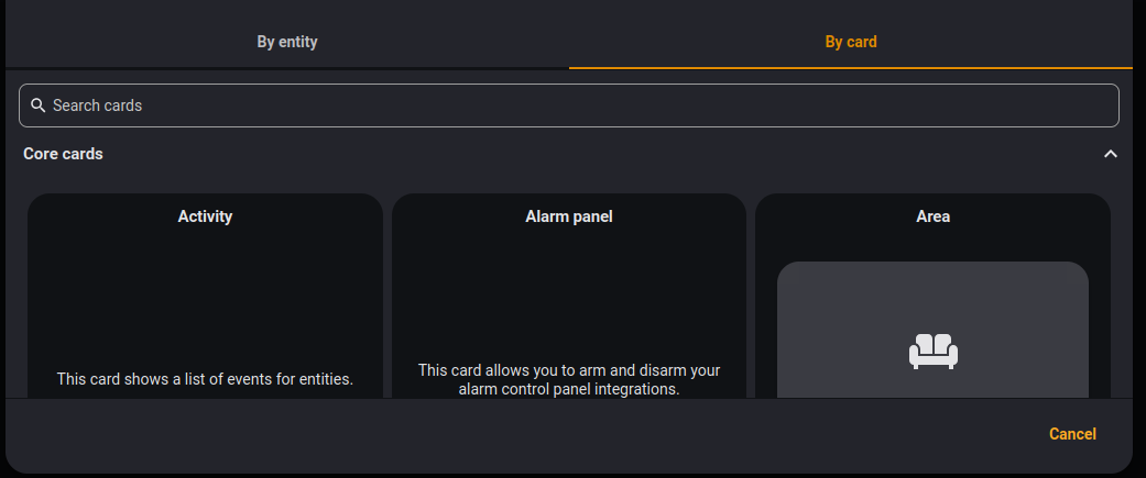

For Dashboard Cards, just click the "By Card" tab:

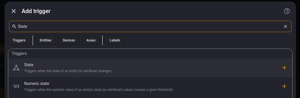

For Triggers and Conditions, I just use the search bar.. that has been the fastest option for a while.

The old card picker is still there too, so I do not understand the problem?

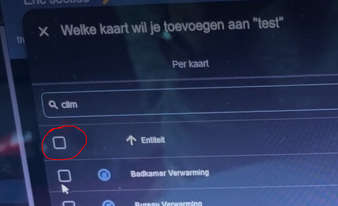

What happens if you click on the box next to Entities before selecting individual entities?
Doesn't that select all entities matching your current filter?

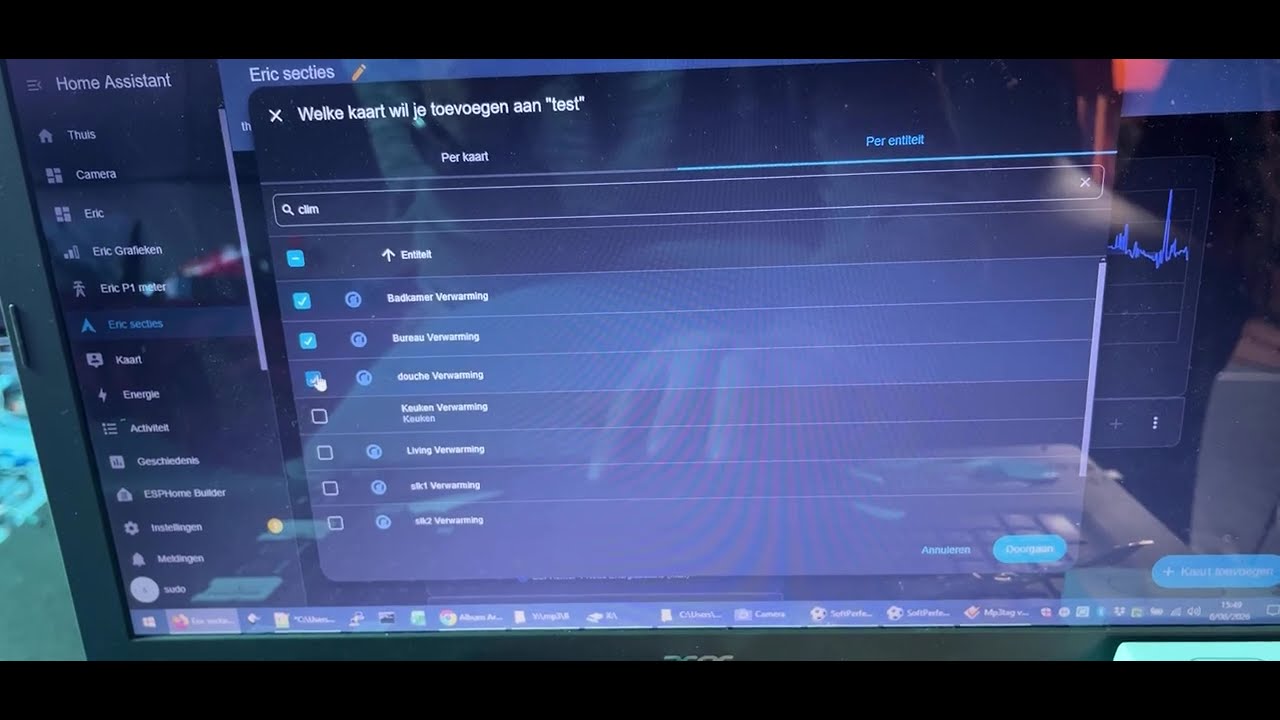

the card picker i never used , i added a video in this topic , on how i add entities in batch
I'm referring to this:
Are you saying that clicking that box causes you to go back to the pick cards screen?
The video is what it looks like before updating to 2026.6.0 when using "By Entity". The check boxes allow you to select multiple entities and then it creates all of them on a dashboard.

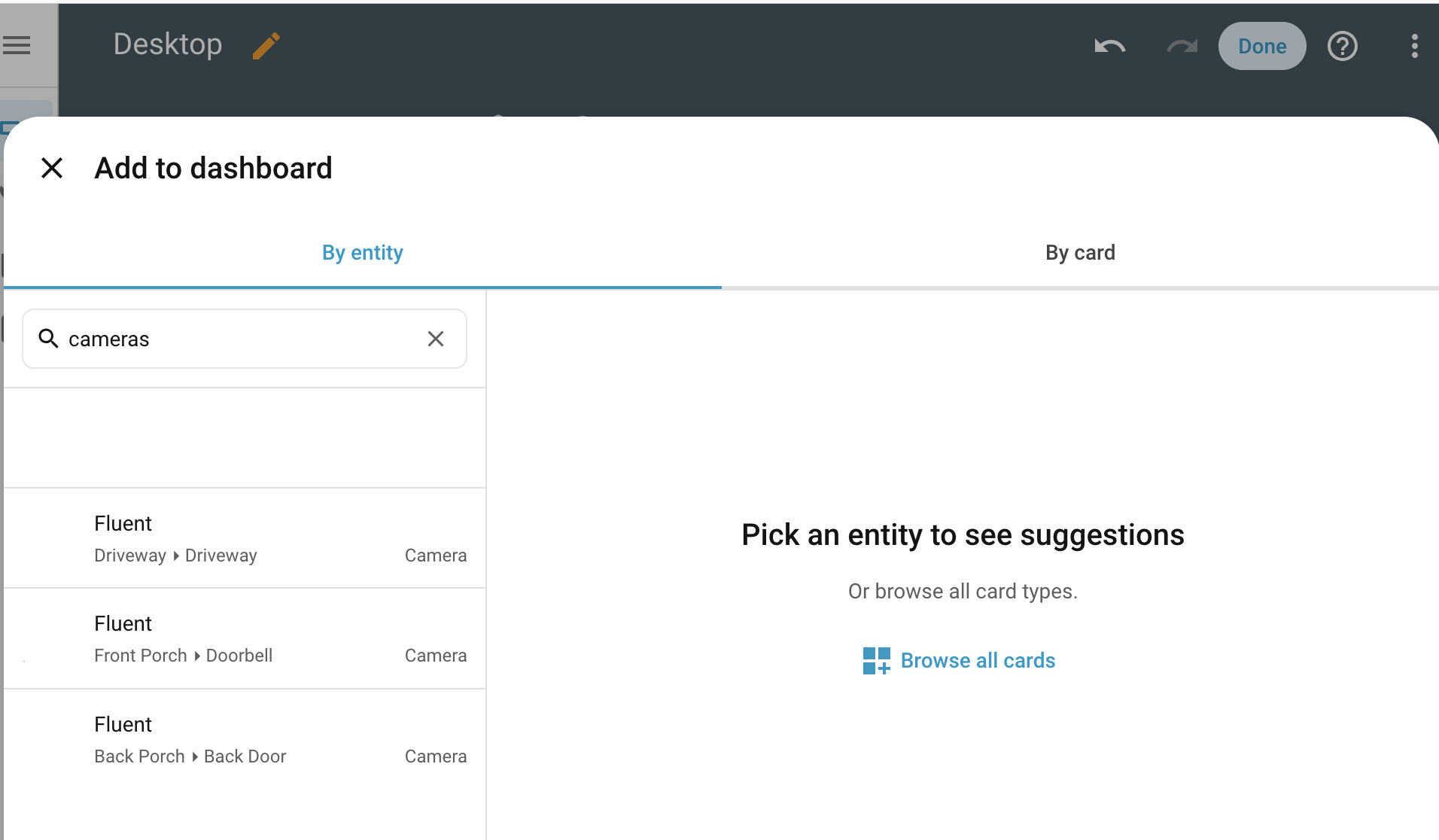

After updating to 2026.6.0, it looks totally different when using "By Entity" There are no check boxes, and no way to select multiple entities...at least I couldn't figure it out).

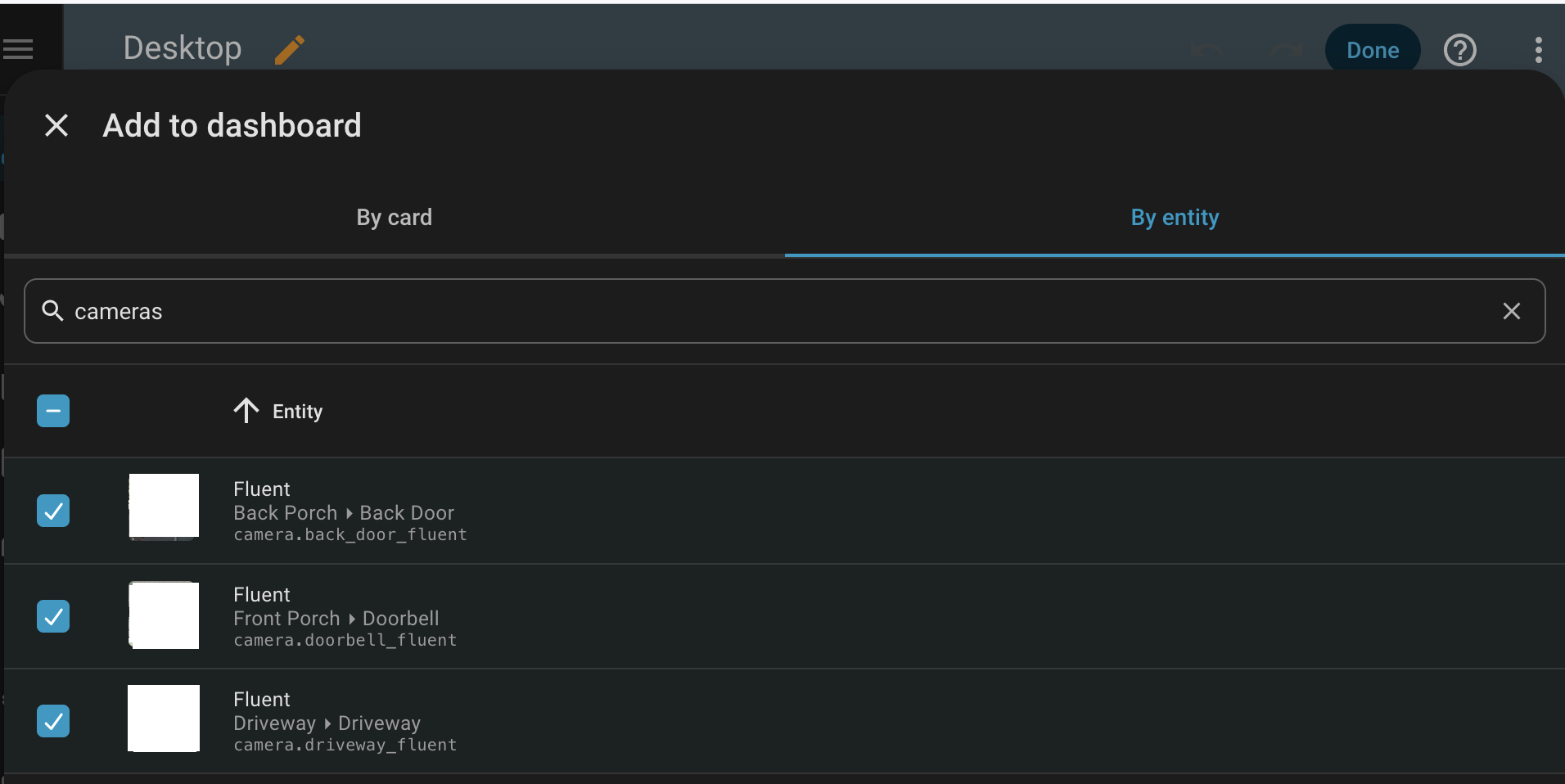

Here's what mine looks like:
On my production server, 2026.5.4
On my test server 2026.6.0, after going through the tree and choosing "Entities". No check boxes to choose multiple entities. Apparently only one entity can be selected.
