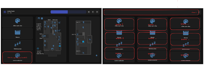

I’m working on a wall-mounted Home Assistant dashboard and would like to add a scene selector. I’ve attached a mockup of what I have in mind.
The idea is simple: clicking a normal dashboard card opens a fullscreen (or almost fullscreen) overlay with a 3×3 grid of scene cards and a close button (ideally this should work the same as the current dasboard builder that you can basically put anything it it).
I’d like to keep this as native to Home Assistant as possible, both visually and technically. The scene cards should look like my normal HA button cards rather than introducing a completely different UI style.
Does something like this already exist, or is there a good native way to achieve it?

I would just use a Subview, and have the “normal dashboard card” either be a Shortcut card or keep the Button card and use the Navigate option for the card action.
Awesome! Thanks a lot for this suggestion I did not know either subviews or navigation cards existed.
works perfect now. Another upgrade to my wall display! Now I’ll spend the rest of the evening creating scenes haha.
