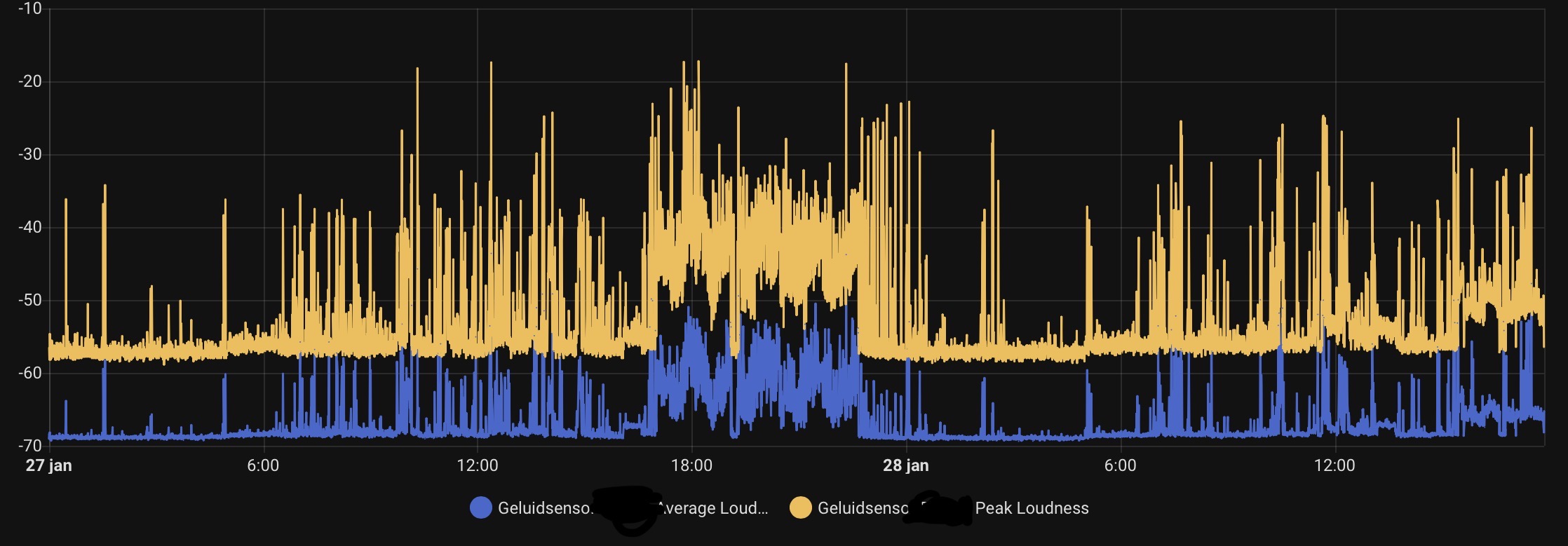

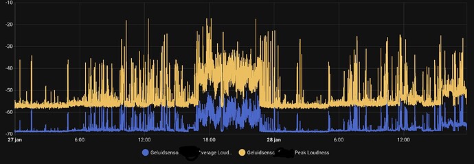

M5Stack Atom Echo:
And this in the yaml:
