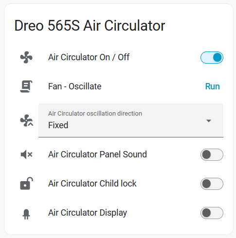

I received the fan today and set it up. I was somewhat disappointed to find I could not control the direction of oscillation. So I created a script that changes it from "Fixed" to "Horizontal", with a delay of 10 seconds, then back to "Fixed". This results in the fan pointing at my wife for her use. Then run the script again and it points back at me.

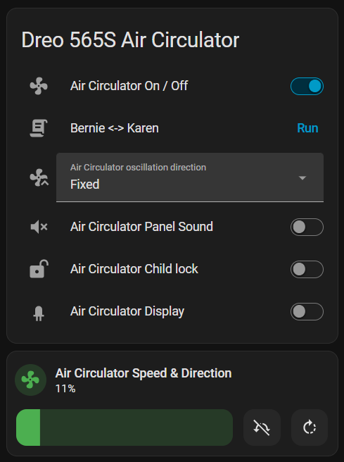

I don't own one of these & I know you found a workaround for the speed, but that's usually in the more-info popup on the main control.
What happens if you click the icon or text of "Air Circulator on/off" (instead of clicking the toggle).
Don't you see additional controls in the more-info popup?
When I click on "Air Circulator on/off" I get the screen below. In the image below that is my final setup in the dashboard. When I click "Run" of the Bernie <-> Karen script, the fan will face my wife. Or back to me. She don't use the fan that often, but it was fun to do. :slight_smile:
