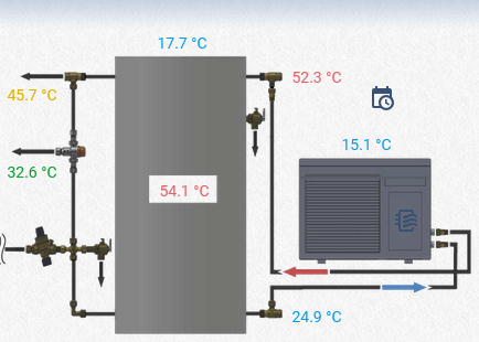

That is a perfect choice. It is what I use for my heatpump hot water.
I’ve had no issues ordering from here: https://www.aliexpress.com/item/1005005874832791.html

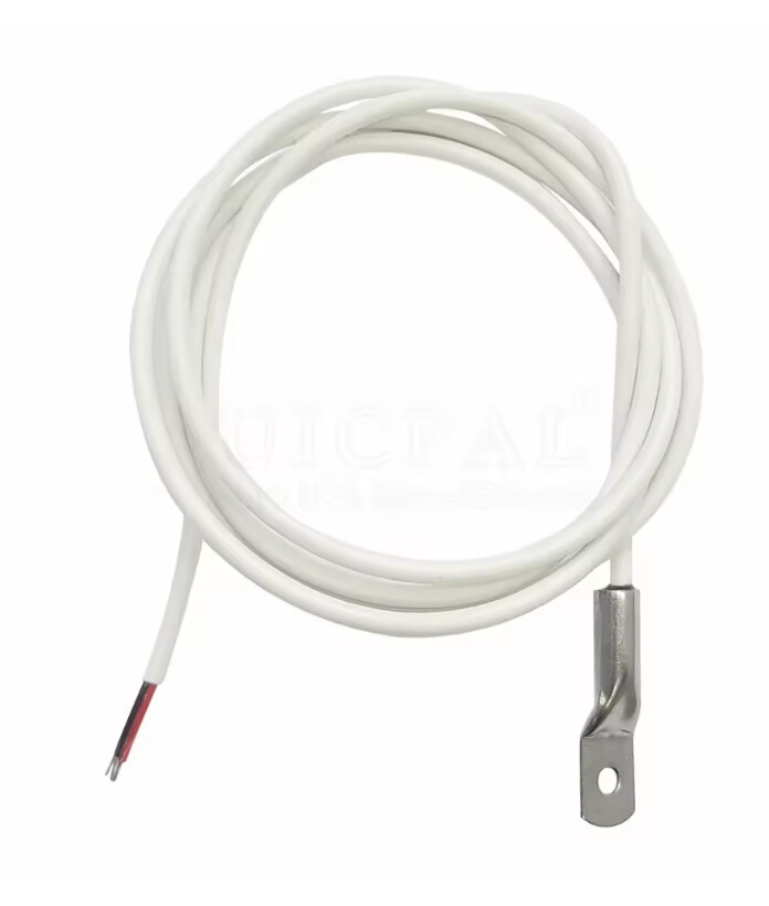

I failed to mention that this is against a flat surface.
I haven’t been able to find any DS18B20 sensors that will mount against a flat surface.
These are available or you can make them yourself:
