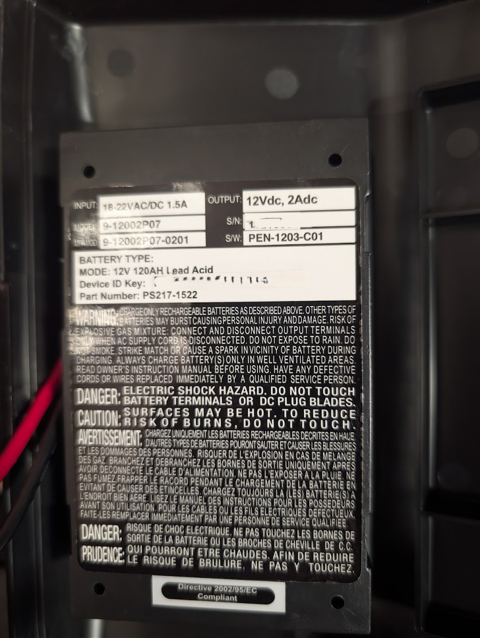

What chips are on each board? A detailed clear close up photo of both sides of each circuit board is worth a million words. This should be your first priority to post this here. Make sure you respect any electrical connections are disconnected, and when you reassemble, be mindful of any waterproofing such as gaskets are well bedded in their initial location.

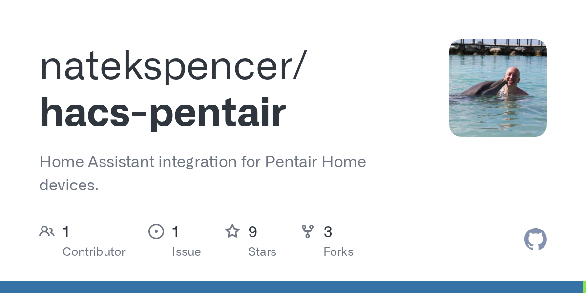

I’ve had this working since natekspencer added it for me in his integration in Jul 2023… very grateful.
too bad this support will come to an end next year.
That integration assumes cloud connectivity. That will disappear in a few months.

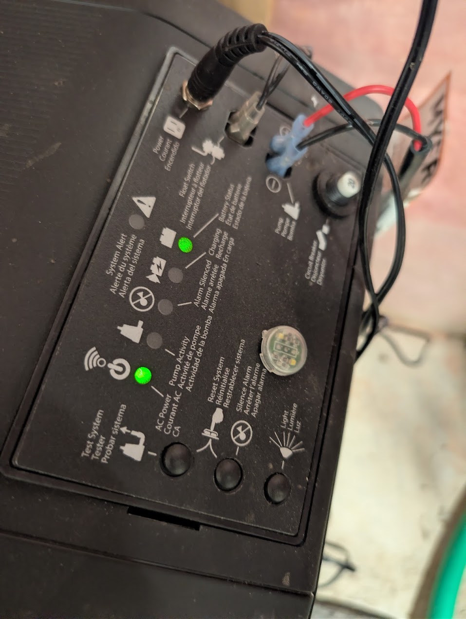

been thinking about this a lot lately… since intercepting the communication has been a losing battle for me… what about recreating their entire brain for the smart sump pump…
looking at it… realistically… all that is needed is a esp device that could monitor the float with those SLA type connectors and alarm on that… as well as provide power and charging monitor to the battery and main pump…
