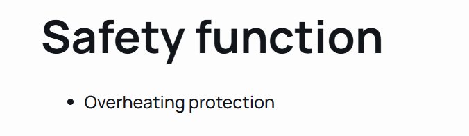

Thank you, before ordering the 1 mini gen 4, I just took a look at the Shelly 1PM gen 4 which seems to have “Internal temperature sensor for overheating protection” is this better for being outside or I am fine with the 1 mini?
The 1 mini also has overheating protection :slight_smile:
