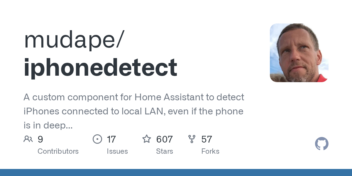

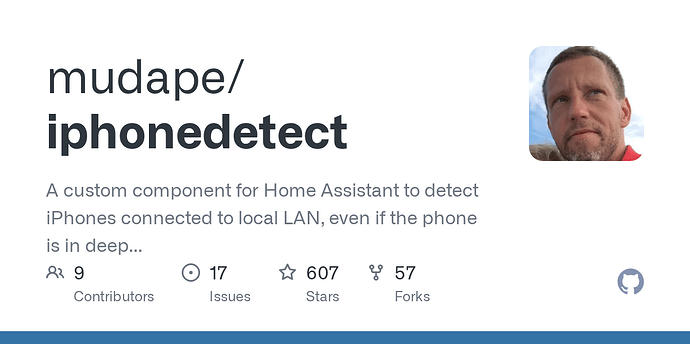

As a little update, some reading turned up a HACS integration titled “iphonedetect” which seems to offer a possibility and although it states iphone in its title, it uses mDNS which is available on most phone os’ now so should be ok with my Android etc
When using iphonedetect, you do need to have a fixed IP, which would require a fixed mac address if DHCP.

iphonedetect (mentioned from @k8gg )
Cant really tell but custom integrations are a pain in the butt sometimes

OK, so I have had the iPhone detect plugin working and it does work, pretty well really, but…
I just had a lengthy phone call over the WiFi (not cellular network) and found the phone was detected as being away due to the wifi disconnecting. I have no idea yet if this is normal on Android (Pixel6) phones but it marks it as pretty big failure.
